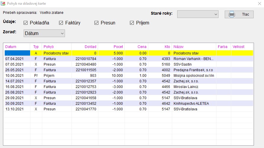

Hello everyone
I would need to consult the GRID function over databases when I use SET FILTER
in the first picture is the whole database
the second image is the result after I used the filter "TYPE" # "X"
line 3 "Doklad" ..... 505
as well as "Doklad" ..... 452
is a duplicate and one blank line is displayed
the number of GRID report lines displayed is the same
the third picture shows the state after using SET FILTER "TYPE" = "P"
is "Doklad" .... 903 is displayed 4x and the other lines are empty

- Grid_1.jpg (107.15 KiB) Viewed 2877 times
- Grid_2.jpg (109.48 KiB) Viewed 2877 times
