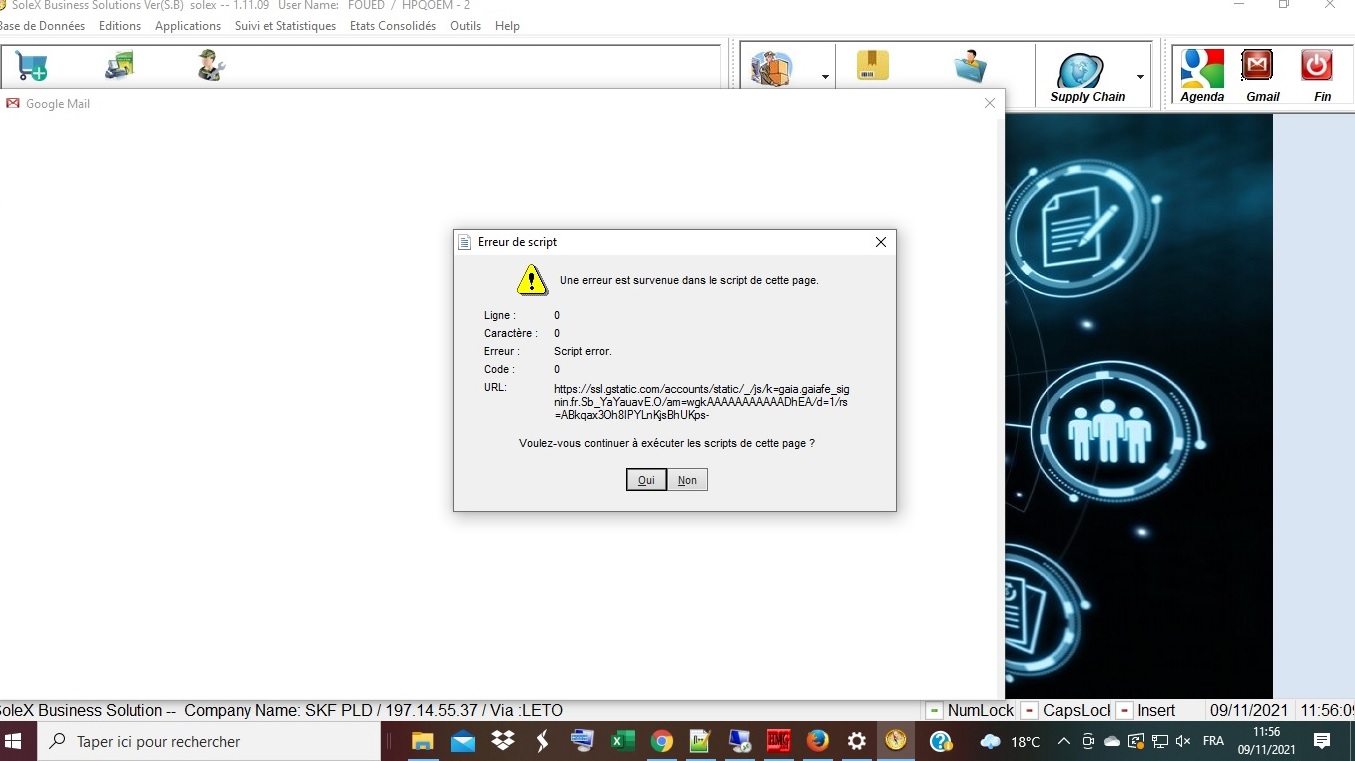

Hi all Friands.
I have this message when open url on my hmg application
- vavigate error.jpg (158.34 KiB) Viewed 8446 times
Re: problem with ActiveX navigate
Hmm, I installed the "Crystal ball of seer" app on my phone, looked through it at your screenshot, and damn, the ball didn't show me the source code, I think this app is broken ....
So I took tarot cards, unfolded the deck and guessing there might be a solution: https://weblog.west-wind.com/posts/2011 ... ie-version

Procedure Http()
cAddress := Alltrim(ARTICLE->LIEN_HTTP)
If len(Alltrim(ARTICLE->LIEN_HTTP)) >0
DEFINE WINDOW Win_http ;
AT 95,0 ;
WIDTH 1024 ;
HEIGHT 620 ;
ICON 'Solex.ICO' ;
MODAL
@ 0,0 ACTIVEX Test ;
WIDTH 1000 ;
HEIGHT 580 ;
PROGID "shell.explorer.2"
Win_http.Test.Object:Navigate(cAddress)
ACTIVATE WINDOW Win_http
AT 95,0 ;
WIDTH 1024 ;
HEIGHT 620 ;
ICON 'Solex.ICO' ;
MODAL
WIDTH 1000 ;
HEIGHT 580 ;
Hi Edk
Find below the value of the ARTICLE-> LIEN_HTTP field
https://www.piecesauto.com/fr/recherche ... 1878085741
Best regards
Best regards
but "shell.explorer.2" , using old IE -Engine, does not work with Java-Script so you get Error Message
i´m not a Internet Guru but i think other User can tell you how to "Download" Website ( CURL ? )
when i disable Java-Script i can not access Website of your Link.fouednoomen wrote: ↑Wed Nov 10, 2021 8:11 am Find below the value of the ARTICLE-> LIEN_HTTP field
So my tarot cards were right.
The page you are trying to display is not entirely compatible with IE.
"Shell.Explorer.2" creates a IE 7.0 embedded browser by default.
You should change the emulation to IE11. However, despite this, the page will not be displayed completely properly. You can check this by launching IE Browser on your computer and entering the address of the problematic website, then do the same in Edge Browser - you will see the differences.
Below code to change IE emulation and disabling error messages:
PS. I am still wondering, while browsing your code, would it be better to open link in the default browser instead of browsing the it in the modal window?
Or https://hmgforum.com/viewtopic.php?p=67093#p67093
Many thanks Edk
it's run perfectly
foued
it's run perfectly
foued
