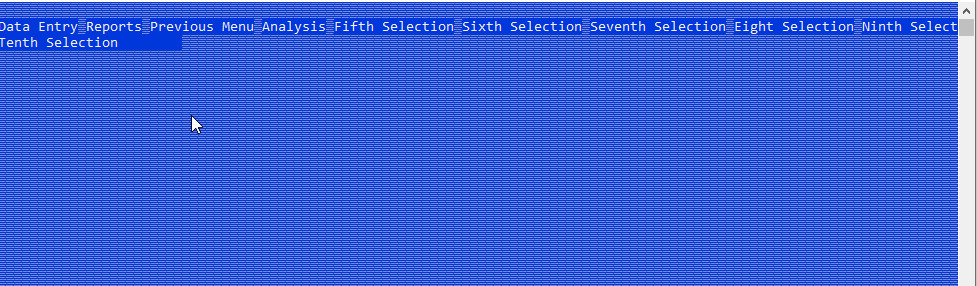

Note: this isn't referring to a grid. I'm just doing some @row, @col Prompt statements.
Specifically, using Grumpfish's Menuh (below), I'm trying to figure out how to scroll the prompts to the right, when the prompts get past the maxcol() on the screen.
This is the Menuh.prg snippet that displays the prompts, from a list of prompts & messages separated by a dollar sign $.
if '$' $ cPrompts
   cPrompts := trim(cPrompts)
   cPrompts := cPrompts + ;

I'm adapting it to Harbour of course, and surprisingly it doesn't require the Grump library.
In the attached images, there are Ten Prompts total.
The Ninth Prompt - mostly - fits on the screen, with just a few characters off to the right.
But the Tenth Prompt is all the way past the MaxCol(). Note that the Message corresponding to the Prompt, does fit on the screen, because it's justified to the Left.
How do we use Scroll() or another function to shift the prompts to the left, so that the Tenth Prompt is visible, while the first Prompt is not visible?
I played with Scroll() a bit, but it's having no effect.
