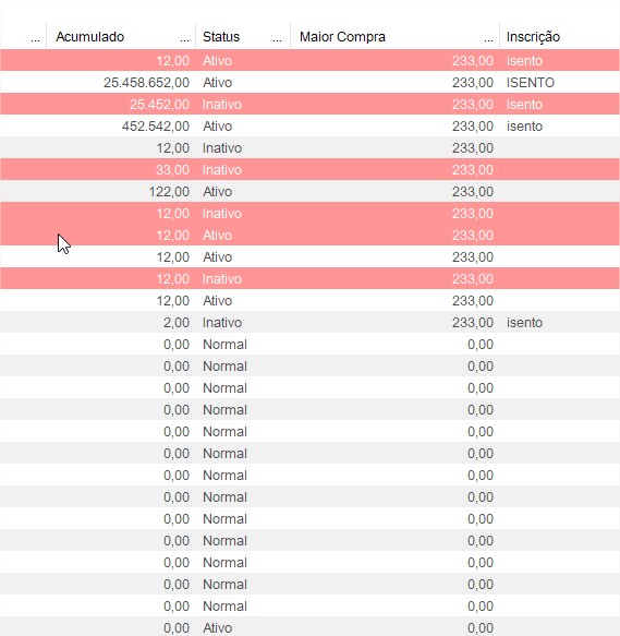

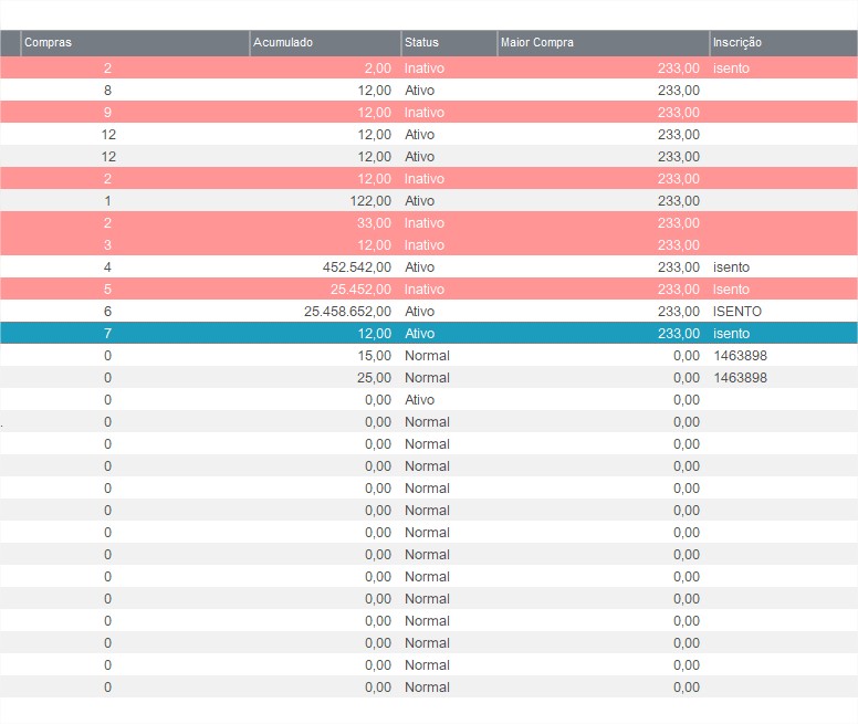

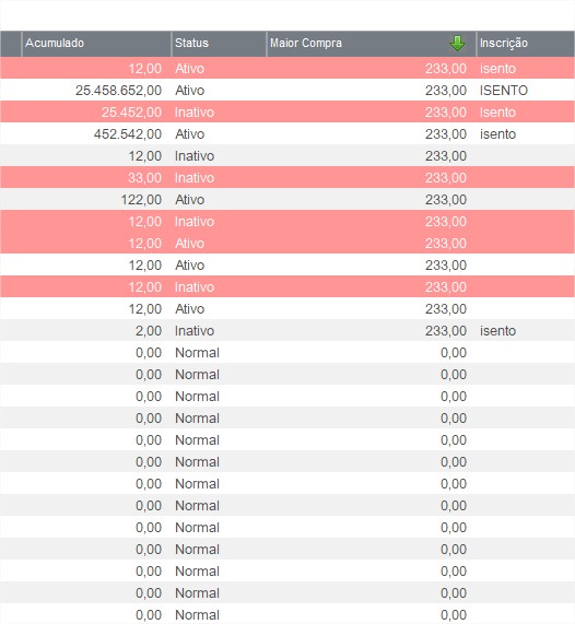

[image][/image]
Greeting to All ,
I Tried to Do it in Grid Component , Something similar to ownerDraw , But it is not 100% , Because it's still flickering sometime . It´s like the windows receveing a message and paint its Background with Default Color.

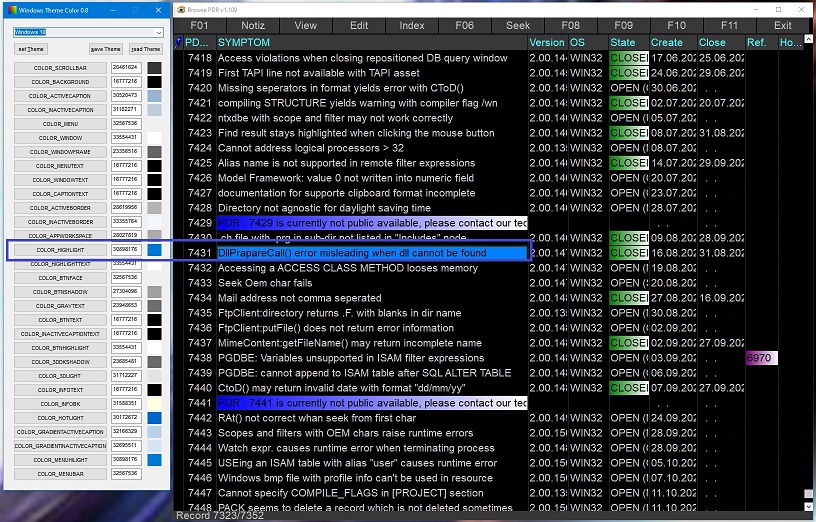

i´m afraid that OwnerDraw is not implement in HMG
as i can say Ownerdraw is only implement in GRID Header under HMG.
the Snapshot show my own native Control made for Xbase++
