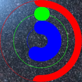

i got Demo of my "Clock" working using HMG ... so far
but i have 2 Problem which can be show in Demo in right-Menu
KreisUhr01.zip
EXE only
(1.47 MiB) Downloaded 70 times

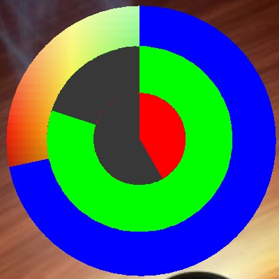

a.) Size and BT_DrawArc()
b.) SetLayeredWindowAttributes() -> Transparency
ad a.) it work correct at 100% and 200% but other Size show wrong "12" Position (for MM and HH), why :?:
ad b.) Transparency have RED Color :o
Question to a.)
to draw "full-fit" Seconds i can use
   Row1 := 0
   Col1 := 0
   Row2 := Height
   Col2 := Width
but how are Coordinate of "inner-Ring" Minute / Hour when use different Size :idea:
Re: DRAW ARC Sample
more Information :
   aCenter := {Width/2, Height/2}
   nRing := 3
   nWidthLine    := INT(Width/2/nRing)
   aColorRGBFill := {55,55,55}
nSS as 1st. "Ring" is working at any Size of Form
   ***************************** nSS *****************************
      OFFSET := Width/2/nRing*1
      nTmp := (nSS-15)*6/60
      Row1 := 0
      Col1 := 0
      Row2 := Height
      Col2 := Width
      ColStartArc := INT(aCenter[1]+COS(nTmp)*OFFSET)
      RowStartArc := INT(aCenter[2]+SIN(nTmp)*OFFSET)
      // not sure why need -120 here ... i know about -90
      ColEndArc   := INT(aCenter[1]+COS(-120))
      RowEndArc   := INT(aCenter[2]+SIN(-120))
      aColorRGBLine := {255,0,0}
     BT_DrawArc(hDC, Row1, Col1, Row2, Col2, RowStartArc, ColStartArc, RowEndArc, ColEndArc, aColorRGBLine, nWidthLine)
now i search for nMM in 2nd. "Ring" which work with "any Size"
   ***************************** nMM *****************************
      OFFSET := Width/2/nRing*2
      nTmp := (nMM-15)*6/60
