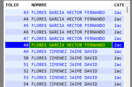

Re: Row BackColor in inactive BROWSE control
En el GRID funciona esto.
Tal vez estudiandolo y entendiendolo, funcione para el BROWSE.
In the GRID this works.
Maybe studying and understanding it will work for the BROWSE.
	CellNavigationColor( _SELECTEDCELL_FORECOLOR, YELLOW )	// CAMBIA COLOR DE CELDA-COLUMNA
	CellNavigationColor( _SELECTEDCELL_BACKCOLOR, GREEN )		// CAMBIA COLOR DE CELDA-COLUMNA
	CellNavigationColor( _SELECTEDCELL_DISPLAYCOLOR, .T. )
	CellNavigationColor( _SELECTEDROW_FORECOLOR, WHITE )		// CAMBIA COLOR DEL RENGLON
	CellNavigationColor( _SELECTEDROW_BACKCOLOR, BLUE )		// CAMBIA COLOR DEL RENGLON
	CellNavigationColor( _SELECTEDROW_DISPLAYCOLOR, .T. )
