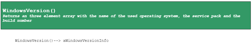

When I say msgbox(windosversion()) .......... I get Home Edition Build 19042
I does not give me windows 10

Hi... Try: https://www.hmgforum.com/viewtopic.php?f=5&t=6921
Function WinVer () Without parameters, return an four elements array with: Name, SP, Build, Data Width

Claudio, this helps me and is what I need.
If Val ( SubStr ( WindowsVersion () [3],7)) < 7602
WIN7F := .T.
Thanks for help.
