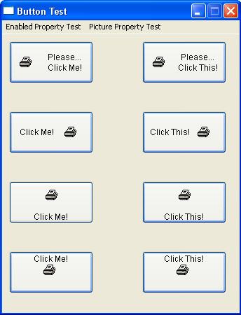

Hi friends,
I have a little issue, see the image bellow. In this image, all buttons is focused.
This example can found in "C:\hmg\SAMPLES\BUTTON.2"
For reproduce this issue.
1 - Click on first button, for it "get" the focus, will show a MSGBOX
2 - Go to the Menu "Enabled Property Test", and go to "Disable Button 1".
3 - Click on second button, will show a MSGBOX, but it don´t get the focus, so click once more, for it get the focus
4 - Go to the Menu "Enabled Property Test", and go to "Disable Button 2".
5 - So, go to the Menu "Enabled Property Test", and go to "Enable Button 1". This will be enabled and will get the focus.
6 - Go to the Menu "Enabled Property Test", and go to "Enable Button 2". This will be enabled and will get the focus too.
I think that the Button Control have 2 levels of focus. Please explain it for me if i´m wrong.
I´m using HMG version 2.9.3 with Windows XP SP/2 with default theme. I not test this fact in another version of our HMG.
I thank any help.
with best regards,
PS: Sorry my bad english
I thank any help.
with best regards,
- Button.JPG (26.3 KiB) Viewed 7037 times

Hi, I don't get like that.
I think, I am missing something in step no. 3
"Click on second button, will show a MSGBOX, but it don´t get the focus, so click once more, for it get the focus" - Why should we click once more? By the way, whether clicking means by left mouse click or using keyboard?
Re: HMG 2.9.3
Hi friend,rathinagiri wrote:Hi, I don't get like that.
I´m using my mouse. I´m clickin with left button of my mouse
You must click once again on second button, for that this get the focus. Beacuse of the first time this not get the focus as you can see.
regards,
Re: HMG 2.9.3
For me, I am getting the message box, in the first click itself (even though it has not got focus). Further, while enabling back, no button has got focus.
I use Vista. What is your version?
Re: HMG 2.9.3
I´m using windows XP SP/2.rathinagiri wrote:For me, I am getting the message box, in the first click itself (even though it has not got focus). Further, while enabling back, no button has got focus.
I not understood. You clicked 2 times on the second button don´t get the focus?
The first button must be focused, for after be disabled, so you must click on second button, will show the MSGBOX "Thanks", but the second button don´t get the focus, so you must click once more in second button, once more will show the MSGBOX "Thanks" and so the second button will get the focus. I did it, after this steps i enable the first and the second button (and all others) and all were with focus.
Re: HMG 2.9.3
Now, I understand.
As you have said, both the buttons seem to be got focus. However, if we press space button to click, it doesn't work.
