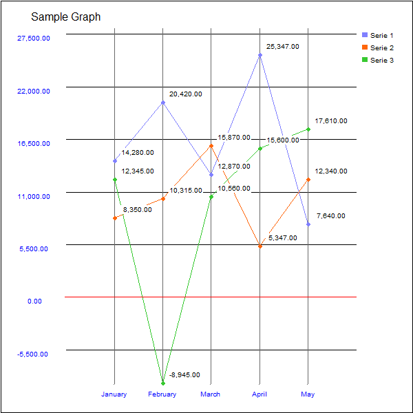

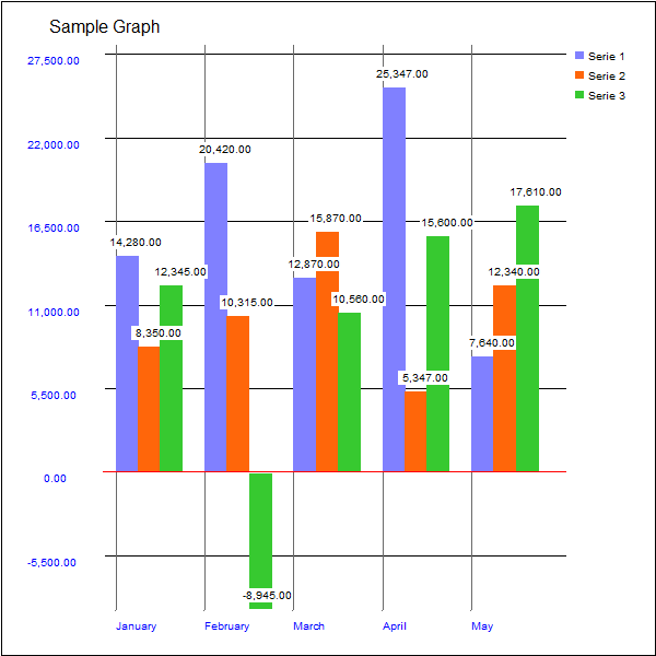

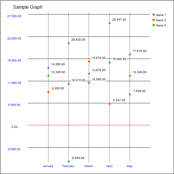

In this post Serge mentioned about the placement of SERIEYNAMES. Now I have fixed the bug for both Bar and Line/Points charts.
Please change h_graphbitmap.prg with the following code and rebuild HMG.

Re: Fix: Graph using Bos Taurus
After replacing h_graphbitmap.org run buildlib32.bat from hmg root folder.
Red2

Hi... what happen if two consecutive bars are similar values ? overlapping value numbers in graph ?
Claudio Ricardo wrote: Mon May 24, 2021 9:20 pm Hi... what happen if two consecutive bars are similar values ? overlapping value numbers in graph ?
Yes! Obviously. As a programmer, we should make either the digits to be shown lesser or we have to increase the width of the graph.
Claudio Ricardo
Posts: 367
DBs Used: DBF, MySQL, MariaDB
Location: Bs. As. - Argentina
Post by Claudio Ricardo »
Hi ... I thought this post was the answer to a request from Emzampi a month ago asking for the option to put the text vertically,
if it was displayed inside the bar it would solve the cut or overlap of the adjacent bar.
I understand it is solved with wider bars or abbreviating the numbers for example removing the decimals or directly not showing the values.
I will replace the original library ... Thank you very much Rathinagiri.
Pd This time help me with Google translator XD
Yes. What you are saying is correct! Writing vertical can solve the problem. :)
Great work my Friend!
Thanks!
