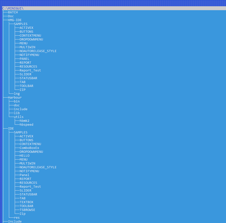

I played with the code for a few days. It's a nice visual simulation of Dos Tree, but it's not really built to be a foundation for a general text mode Tree viewer.
Thanks to anyone who looked at the code, and considered it. I'll try another approach, right now it's just trial & error.

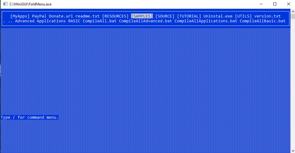

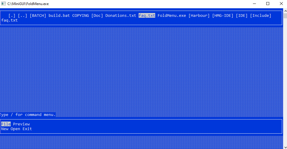

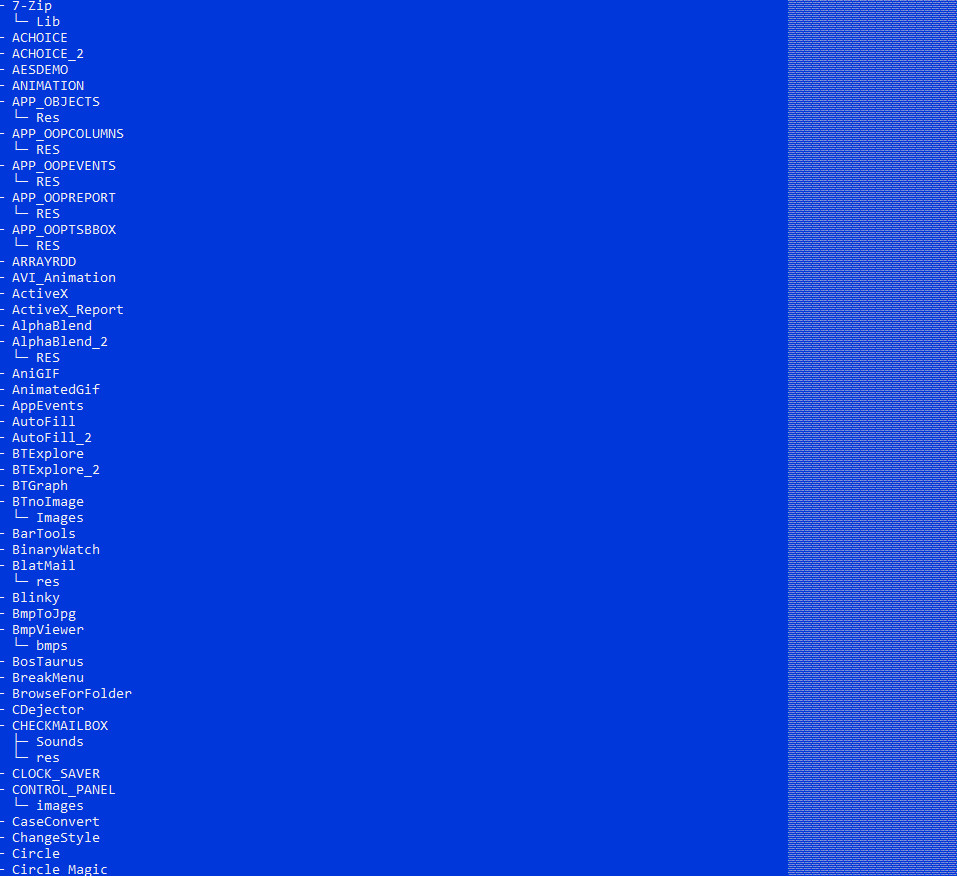

Still playing with this, but there's no structural solution or official project yet. I haven't had the chance yet to devote as much time as it deserves.
This looks much better visually, and uses various public domain snippets to achieve the effect of a navigator. Not close to the objective yet, but definitely better.
https://github.com/HBEnthusiast/Harbour ... irTree.zip
There's a related navigation utility, that I've been devoting more time to, because it's much easier to implement the interface. It's based on Super.lib's SLOTUSMENU, with some modifications. I'll share the code for this, after we work out 5-6 bugs.

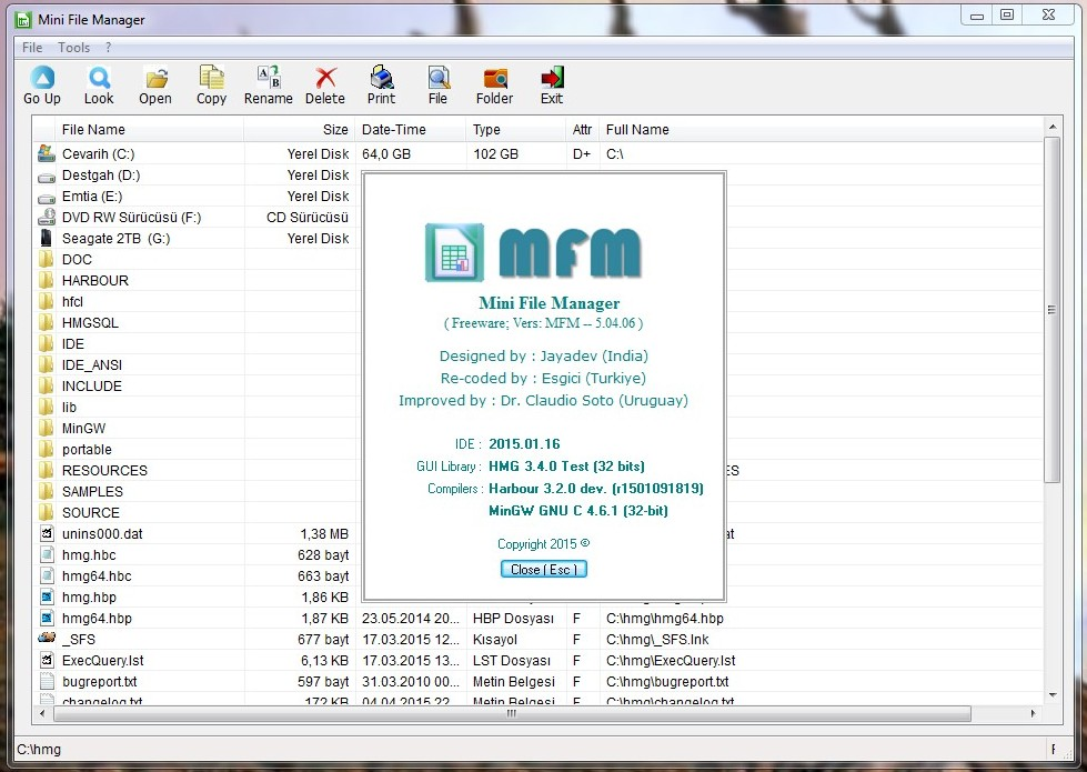

Thanks, but there are lots of Windows examples floating around. I mean, Windows itself has a treeview. I want to build something in 32 or 64-bit text mode.
The Turbo C example you pointed to might be of some value, thanks for that. Unfortunately, the link that was provided in that post

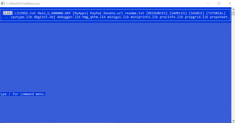

I'm no longer certain that a Tree-based navigation system is worth writing in Harbour, since there are full-featured applications already available, as other posters have indicated. Building a simple tree is certainly feasible, but adding all the frills would take years.
Here is the source code for the Lotus-style navigator. This will be updated.
LotusMenu.prg:

// TODO
Function Load_Program_Menu( oTb )
Local Program_Menu_a := {}
Program_Menu_a := { { "File", "New Open Exit", { || Alert( "File menu" ) } }, ;
										{ "Preview", "As Text  As Binary  As OutLine", { || Alert( "Preview menu" ) } } ;
SLOTUSMENU(23,0,24,MaxCol(),Program_Menu_a,.t.,.t.,.t.)
DirectoryMenu.prg:
#include "FILEIO.CH"
#INCLUDE "COMMON.CH"
#INCLUDE "i_pseudofunc.CH"
#INCLUDE "hbcompat.CH"
#define ISARRAY(x)    (valtype(x)=='A')
#define ISLOGIC(x)    (valtype(x)=='L')
#define ISNUMERIC(x)  (valtype(x)=='N')
#define ISCHAR(x)     (valtype(x)=='C')
#define ISDATE(x)     (valtype(x)=='D')
#define ISOBJECT(x)   (valtype(x)=='O')
#define ISNIL(x)      x=NIL
#define NTrim( n ) LTRIM( STR( n,20, IF( n == INT( n ), 0, set(_SET_DECIMALS) ) ))
 Function Directory_Menu( Current_Directory_s )
Local Directory_a := {}
Local Names_a := {}
Local Name_s := ""											// Directory names with brackets e.g. "[ProgramData]"
Local Name_without_Brackets_s := ""
Local Attr_a := {}
Local Attr_s := ""
Local Main_Menu_a := {}
Local DirectoryEntries_n := 0
Local Nth_Directory_Entry_n := 0
Local Nth_Directory_Entry_s := ""
Local Message_s												// String list of subfolders & files in the parent directory.
Local SubDirectory_s := ""
Local SubDirectory_Path_s := ""
Local SubDirectory_Files_a := {}
Local SubDirectory_Files_n := 0
Local Nth_SubDirectory_File_n := 0
Local Nth_SubDirectory_FileNames_a := 0
Local Nth_SubDirectory_File_s := ""
Local Nth_SubDirectory_FileNames_s := ""
If Current_Directory_s == Nil
	Current_Directory_s := CurDir()
End If
Directory_a         := DIRECTORY( "*.*", "HSD" )
Names_a       := A2TOSING(Directory_a,1)
Attr_a	 := A2TOSING(Directory_a,5)
AEVAL(Names_a,;
{|cValue,nIndex| IF(  Attr_a[nIndex] == "D",;
                     Names_a[nIndex] := "[" + Names_a[nIndex] + "]",)})
DirectoryEntries_n := Len( Names_a )
For Nth_Directory_Entry_n := 1 To DirectoryEntries_n
	Nth_Directory_Entry_s := Names_a[ Nth_Directory_Entry_n ]
	Name_s := ""
	Attr_s := Attr_a[ Nth_Directory_Entry_n ]
	Message_s := Nth_Directory_Entry_s
	// If pointing to a directory, then obtain list of subdirectories and files within that directory
	If Attr_s == "D"
		Name_without_Brackets_s := StrTran( Nth_Directory_Entry_s, "[", "" )
		Name_without_Brackets_s := StrTran( Name_without_Brackets_s, "]", "" )
		SubDirectory_Path_s := CurDrive() + ":\" + Current_Directory_s + "\" + Name_without_Brackets_s + "\*.*"
		SubDirectory_Files_a := DIRECTORY( SubDirectory_Path_s, "HSD" )
		Nth_SubDirectory_FileNames_a  := A2TOSING(SubDirectory_Files_a,1)
		Nth_SubDirectory_FileNames_s := Array_to_List( Nth_SubDirectory_FileNames_a, " " )
		// Message line will contain list of filenames and subdirectories, within the directory currently selected.
		Message_s := Nth_SubDirectory_FileNames_s
	EndIf
	AAdd( Main_Menu_a, { Nth_Directory_Entry_s, Message_s, ;
		{ | Col_n | DoSomething( Current_Directory_s,  Names_a[ Col_n ], Attr_a[ Col_n ] ) } } )
Next
cls(23, chr(177))
SETCOLOR( "W+/B,B/W,,W+/B")
Lotus_Menu(0,0,0,MaxCol(),Main_Menu_a,.t.,.t.,.t.)
Lotus_Clear()
