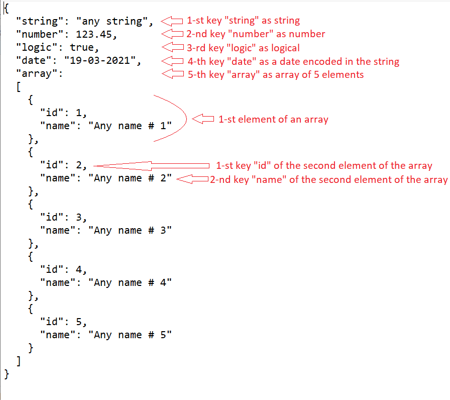

Basado en la documentación de esta página https://goo.gl/WHMmSb, hice un ejemplo de este tipo:
MEMVAR _HMG_SYSDATA
#include "hblang.ch"
REQUEST HB_LANG_ESWIN
request HB_CODEPAGE_ESWIN
REQUEST HB_LANG_ES
request HB_CODEPAGE_ES850
Local cUrl := "https://www.nubefact.com/api/v1/48239908-7ae7-071765d4"		//"https://demo.nubefact.com/api/v1/03989d1a-6c8c-4b71-b1cd-7d37001deaa0"
Local cToken := "8d19d8c7c1f6402687720eab85cd57a54f5a7a3fa163476bbcf381ee2b5e0c69"		//"d0a80b88cde446d092025465bdb4673e103a0d881ca6479ebbab10664dbc5677"
Local nTimeOut := 20  //seconds
Local oRestApi, cResp
Local hFactura, hItem, hGuias, hVenta_al_credito
set( _SET_CODEPAGE, "ES850" )
hb_LangSelect( 'ES')
//prepare json
hFactura := { => }
hFactura ["operacion"] := "generar_comprobante"
hFactura ["tipo_de_comprobante"] := 1
hFactura ["serie"] := "FFF1"
hFactura ["numero"] := 1
hFactura ["sunat_transaction"] := 1
hFactura ["cliente_tipo_de_documento"] := 6
hFactura ["cliente_numero_de_documento"] := "20600695771"

Please forgive me, but I'm not a very good teacher, so let me use an example.
Basically a Hash is an array of elements where each element consists of two pairs: a key and a value. The key is a unique name, while the value can be of the following data types: string, numbers, logical values, and arrays (which can contain consecutive Hash or other arrays - as in multidimensional arrays).
json sample.png (28.38 KiB) Viewed 17626 times
Local hHash, aArray, hHashArray, i
//declare hash
hHash := { => }
//add key "string" to hHash
hHash ["string"] := "any string"
//add key "number" to hHash
hHash ["number"] := 123.45
//add key "logic" to hHash
hHash ["logic"] := .T.
//add key "date" to hHash (date will be encoded as string in DD-MM-YYYY format)
hHash ["date"] := hb_DtoC ( hb_Date(), "DD-MM-YYYY" )
//add key "array" to hHash
//key "array" is an array of hHashArray
//first - prepare empty array
aArray := {}
FOR i=1 TO 5	//array will have 5 elements of hHashArray
	//prepare empty hHashArray for i-th elements
	hHashArray := { => }
	//add 1st key "id" to hHashArray
	hHashArray["id"] := i
	//add 2nd key "name" to hHashArray
	hHashArray["name"] := "Any name # " + AllTrim( Str ( i ) )
	//hHashArray have 2 keys -> add this hHashArray to aArray
	AADD( aArray, hHashArray )
NEXT i
//aArray have 5 elements, each element consists of a Hash array containing the "id" and "name" keys
//we assign the value of aArray to the "array" key
hHash ["array"] := aArray
//we already have a hash consisting of the following keys and their data
  "string": "any string",
  "number": 123.45,
  "logic": true,
  "date": "19-03-2021",
  "array": [ {"id": 1, "name": "Any name # 1"}, {"id": 2, "name": "Any name # 2"}, {"id": 3, "name": "Any name # 3"}, {"id": 4, "name": "Any name # 4"}, {"id": 5,"name": "Any name # 5"} ]
//let's code our hash to json format and save it to the hHash_json.txt file
StrFile (hb_jsonEncode( hHash , .T. ), "hHash_json.txt")
MsgInfo (FileStr ( "hHash_json.txt") )

Muchas Gracias EDK por tu respuesta...
No sabía que la vieja función AADD () también podía adicionar datos a un array desde un hash.
//add hVenta_al_credito to aVenta_al_credito array
AADD ( aVenta_al_credito , hVenta_al_credito )
y de ahí vino mi confusión.
Muy agradecido por aclarar mis dudas y enseñarme algo nuevo (para mi) y muy útil.
English with Google traducer:
Thank you very much EDK for your answer ...
I didn't know that the old AADD () function could also add data to an array from a hash.
And that's where my confusion came from.
Very grateful for clarifying my doubts and teaching me something new (for me) and very useful.

hAtributi ["Amount"]              := 1001
hAtributi ["IssueDate"]           := "2018-02-28"
hAtributi ["Comments"]            := "Komentar 1"
//Add 1st invoice to array
AADD (aFaktura, hAtributi )
//2nd invoice
hAtributi := { => }
hAtributi ["DebtorCompanyNumber"] := "10523"
hAtributi ["InvoiceNumber"]       := "Racun 18/02"
hAtributi ["Amount"]              := 1002.33
hAtributi ["Comments"]            := "Komentar 2"
hAtributi ["Lifetime"]            := 88
//Add 2nd invoice to array
strfile (hb_jsonEncode( aFaktura , .F. ), 'register_json.txt')
