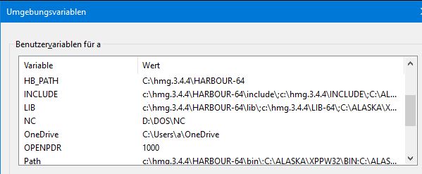

Ok, i understand : Environment is missing :!:
like under Cl*pper i recommend to set Path, INCLUDE and LIB
run this
rundll32.exe sysdm.cpl,EditEnvironmentVariables
add Path, INCLUDE and LIB (here 64 Bit Version)
INCLUDE=c:\hmg.3.4.4\HARBOUR-64\include\;c:\hmg.3.4.4\INCLUDE\;
LIB=c:\hmg.3.4.4\HARBOUR-64\lib\;c:\hmg.3.4.4\LIB-64\;
PATH=c:\hmg.3.4.4\HARBOUR-64\bin\;
last line will point to hbmk2
re-Login to get new Environment
C:\hmg.3.4.4\build64.bat have some more "SET" which is need before BuildLib work correct
