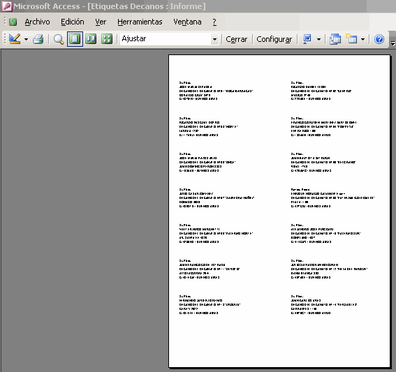

Mi consulta es como tengo que hacer para crear etiquetas postales con HMG.
Actualmente uso el ACCESS que utiliza una DBF y puedo crear etiquetas postales segun las imagenes que adjunto.

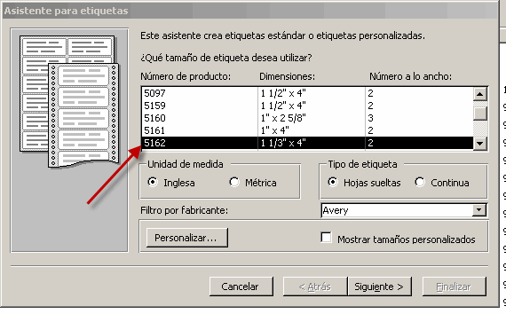

Hay alguna forma de seleccionar en HMG que tipo de tamaño de etiqueta puedo usar?
En access uso Avery 5162
Gracias y saludos
Hello People
My query is as I have to do to create mailing labels with HMG.
We are using the ACCESS using a DBF and I can create mailing labels according to the attached images.
There any way to select which type of HMG label size can I use?
Access in use Avery 5162
Thanks and regards

You can do it with the new report writer. You must define empty header and footer bands and use appropriate positions to define two labels in the detail band.claudiotedesco wrote:Hola Gente

I've not tested, so, some problem could arise, but you could test it.
Roberto.
