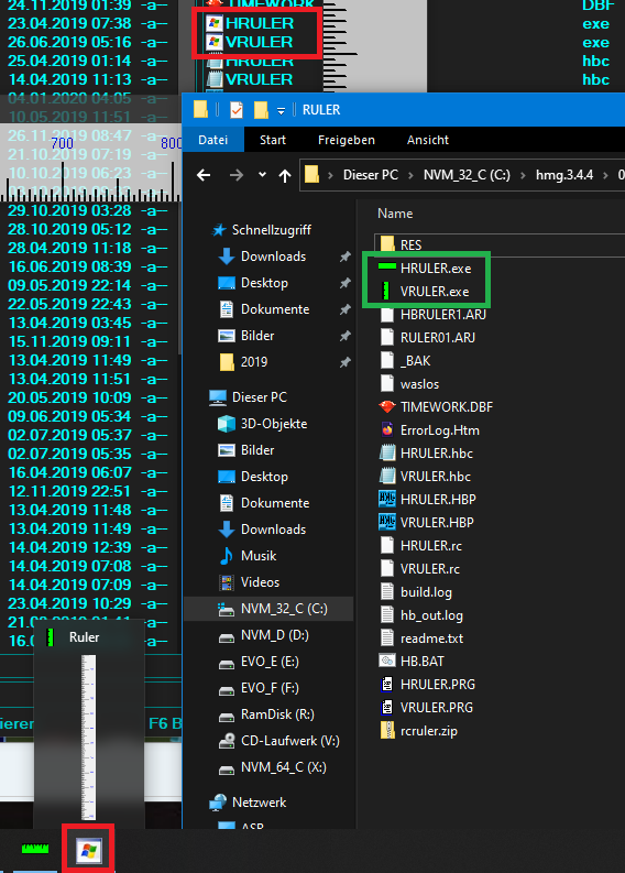

i have release Sample RULER with 2 Icon.
it work with HRuler but not with VRuler and all seem me the same (*.RC = 25 Byte) :(
but both does not show Icon in Explorer so what do i miss :?:
when crash at compile/link i got _hmg_resconfig.h and _temp.rc
1 24 HMGRPATH\Windows7.Manifest
so "Number 1" is used any "my Setting" are on End of _temp.rc
is there a Way NOT to use _hmg_resconfig.h and _temp.rc but my *.RC :idea:
how is the right Syntax for MAIN Icon in *.RC
how do i "set" in in FMG (i use full path to Icon)
need some advice, thx

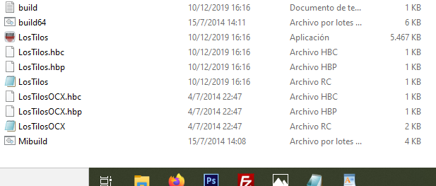

Mi resource file
Shopping        ICON    Icons\shopping.ico
Shopcart        ICON    Icons\shopcart.ico
Barcode	     ICON    Icons\barcodereader.ico
Carrito           ICON    Icons\carrito.Ico
Form main
DEFINE WINDOW Principal ;
              AT 6 , 6 ;
              WIDTH 1010 HEIGHT 710;
              TITLE "Autoservicio Los Tilos 2014" ;
              ICON "Shopping";
              MAIN ;
              ON INIT    ON_INIT_Principal();
              NOMAXIMIZE NOMINIMIZE NOSIZE  NOSYSMENU;
              ON PAINT   ON_PAINT_Principal()
rc file.png (29.66 KiB) Viewed 3931 times

yes now i got both Icon in Explorer, THX :D
... but i still have Problem with vertical Icon in Taskbar ... and Total Commander

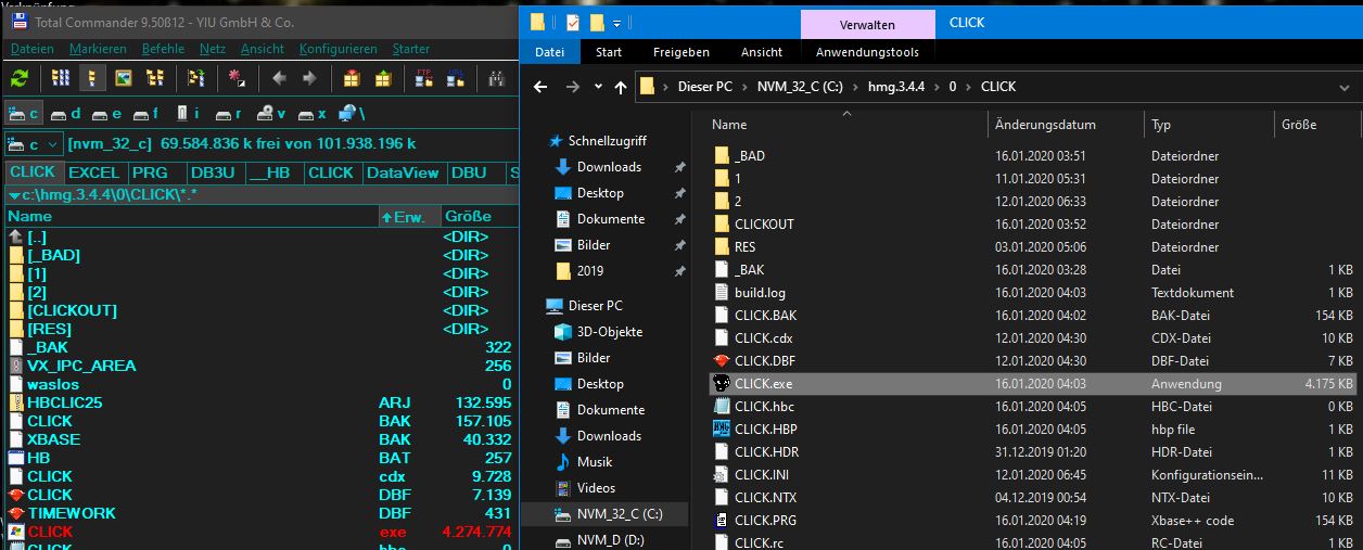

now i get Icon also in Total Commander ... but only if i create a New Folder and compile/link there :o
does somebody have a Idea why it does not work in Original Folder :idea:
Re: HMG Resource MAIN Icon in Explorer
Posted: Thu Jan 16, 2020 5:33 am
by AUGE_OHR
got Solution for Icon ... have to do with Windows Icon Cache
all Apps must be close to run this
TASKKILL /f /im explorer.exe
CD /d %userprofile%\AppData\Local
DEL IconCache.db /a
START explorer.exe
EXIT
and all Icon for "Cache" will rebuild.

again i had Problem with "Main" Icon ... have to do with "sort" in *.RC
MYMAIN     ICON RES\NCC.ico
MYUNKNOWN  ICON RES\IcoDriveUnknown.ico
MYFIXDRIVE ICON RES\IcoDrive.ico
MYFLOPPY   ICON RES\IcoFloppy.ico
MYUSBREMO  ICON RES\IcoSDcard.ico
MYSYSDRIVE ICON RES\IcoDriveSys.ico
MYNETDRIVE ICON RES\IcoNetDrive.ico
MYCDROM    ICON RES\IcoCDROM.ico
MYRAMDISK  ICON RES\IcoRAM.ico
HAND	   CURSOR res\hand.cur
FINGER	   CURSOR res\finger.cur
MYMAIN is the Icon i want but i got MYCDROM so there mus be some "sort" of *.RC Name :!:
now i rename my 1st Icon into
A1MAIN     ICON RES\NCC.ico
and it is shown as "Main" again (after clear Icon Cache and re-start App like TC)
