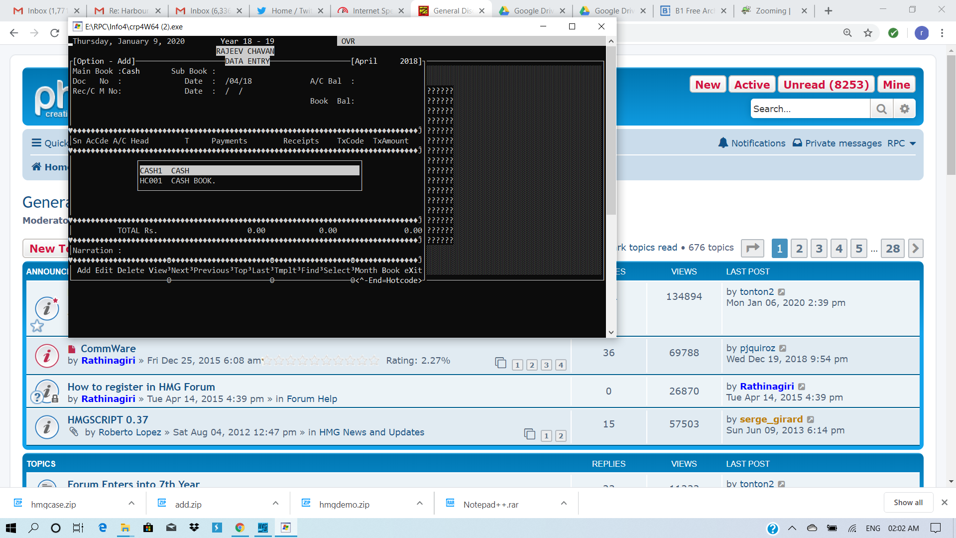

I have compiled old clipper program in console mode using HMG 3.4.4 build 64/32 on laptop having win 10 64 bit.
When I run the program I get console window which produces "diamond" lines in place of straight lines as produced in 32 bit win 7.
also the console window shows characters different from expected characters.  I have enclosed SS from both os 32 bit

and 64 bit
Console window 64 bit.png (268.69 KiB) Viewed 29747 times
How can I get proper console window in 64 bit machine

I use "chr(195)+replicate(chr(196),r-l-1)+chr(180)" for drawing the line which is producing heart and diamonds.CHR(195)=├,CHR(196)= ─,CHR(180)= ┤
The box in the middle is drawn using achoice. In that also when I press down arrow key the bottom line of box turns into diamonds
I have also used CHR(194)= ┬,CHR(179)=│,CHR(193)= ┴ at the bottom, to draw vertical lines which also shows superscript 3 instead of │
