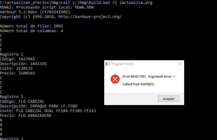

Can you please tell me how to read the array that is generated...
In this way:
FOR j:=1 to Len(aExcel)
    codigo      := aExcel [J][1]
    descripcion := aExcel [J][2]
    costo       := aExcel [J][3]
    precio      := aExcel [J][4]
    ? Valtype(codigo)
    ? Valtype(descripcion)
    ? Valtype(costo)
    ? Valtype(precio)
    ? 'Registro ' + Alltrim( Str(j) )
    ? hb_utf8ToStr('Código: ') + codigo
    ? hb_utf8ToStr('Descripción: ') + descripcion
    ? 'Costo: ' + costo
    ? 'Precio: ' + precio
It doesn't read correctly and an error occurs.
Sample Excel file
The use of hb_utf8ToStr is to correctly display characters (Spanish) and nothing else
ADO because I am using MS-SQL Server database.
Javier
Re: Leer archivo Excel / lectura lenta
Así a simple vista, como que estás tomando los datos de los 4 primeros registros...
Quizá deba ser:
    codigo        := aExcel [1][J]
    descripcion := aExcel [2][J]
    costo          := aExcel [3][J]
    precio         := aExcel [4][J]
Y como Costo y Precio son numéricos, no los puedes concatenar, da ese error.
jparada wrote: Sat Dec 21, 2019 6:14 pm Can you please tell me how to read the array that is generated...
    ? Valtype(codigo)
    ? Valtype(costo)
    ? Valtype(precio)
as you see you got Type "C" for your Variable so you need VAL() for numeric.
if you just want to "?" it use hb_valToExp() -> String
