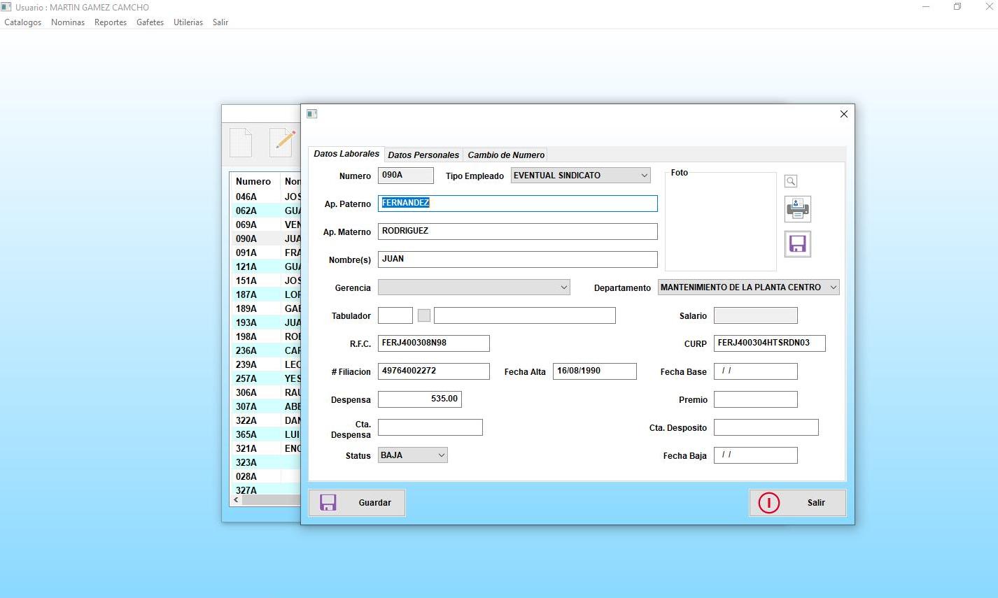

Something like this, the background screen is the grid, I double click and the window appears in the front with the information,

martingz wrote: Fri Nov 22, 2019 4:34 pm Something like this, the background screen is the grid, I double click and the window appears in the front with the information,
YES ... but now, leave Detail Form open, i want to go to GRID an take another Item and DblClick.
i'm now on a other Record an got Data from "this" Record, or :?:
