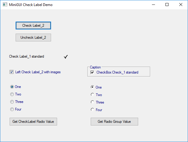

AUGE_OHR wrote: Thu Nov 21, 2019 4:43 am hi,
i seems me that FONTCOLOR only work on Frame but not on FONT :?:
Did you mean the controls look as at the following picture :?:
Which controls look is your preferable - on a right or on a left side :?:

AUGE_OHR wrote: Fri Nov 22, 2019 5:59 am hm ... your Font have Color but my Font have not :?:
p.s. is it possible to set different Color :?:
Yes, it is possible with using of the NO THEMED controls in the modern Operating systems.
It will be available at a next MiniguiEx build.
I've added the following description at a current changelog file:
* Enhanced: The CHECKBOX, FRAME and RADIOGROUP controls supports the FontColor
and BackColor properties in the THEMED Operating Systems.
It was a postponed user's request.
Contributed by Grigory Filatov <gfilatov@inbox.ru>
(see demo in folder \samples\Basic\CheckLabel_2)
Hope that useful :idea:
