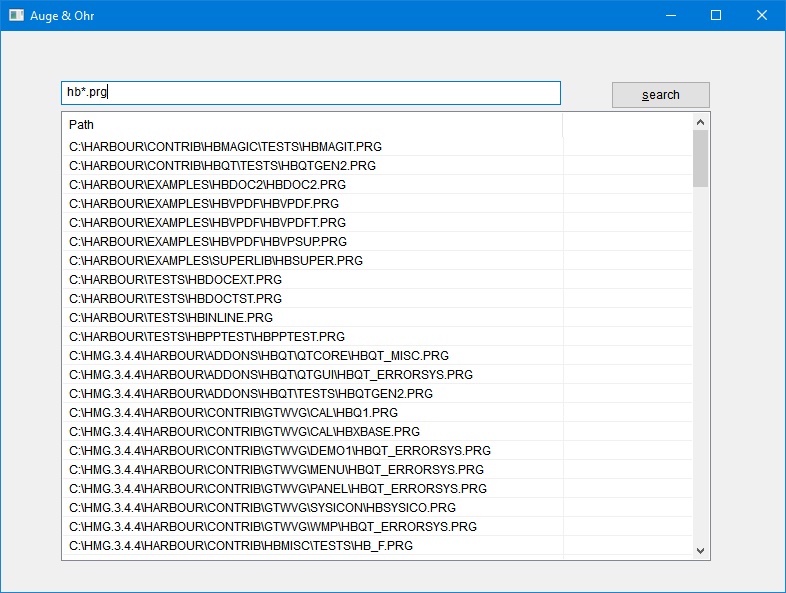

and it search now much faster than before. :o
i found out that i can use Everything.DLL in my Xbase++ App.
this Version now is for harbour / HMG
HBEVERY.ZIP
(2.42 KiB) Downloaded 278 times
! Note : have use BCC582 see HBC
Question : how to detect if a DLL can be load :?:
   nDLL := LoadLibrary("Everything32.dll")
this Code does not work with HMG (perhaps Extended Version can do it)

when found what you search you can "goto" it with this Code
add under GRID_1
    ON DBLCLICK GoToDir(EVFORM.Grid_1.Value,ThisWindow.Name,This.Name)
and insert this Code
STATIC PROCEDURE GoToDir(nDir,cForm,cGrid)
LOCAL cText  := ""
LOCAL cPath  := ""
   cPath := GetProperty( cForm, cGrid, "CELL", nDir, 1 )
   cText  := "explorer /e,/select,"+cPath
   MemoWrit("ChangeDir.BAT",cText)
   RUN ChangeDir.BAT

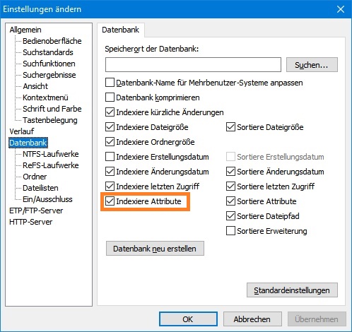

i also use Everything to find files with Attribut "A" for Backup.
you have to configure Everything in Setup and enable Attribut.
than you can search with
"D:\ALASKA\ attrib:A"
this will search for all files with Attribut "A" under D:\ALASKA\
you have to modify Code for Attribut with other Constant this Way
