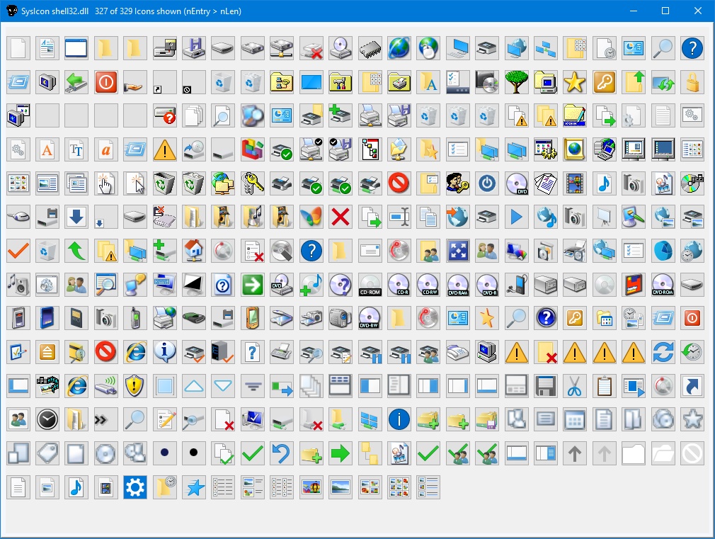

i want to make this
Shell32 Icon.jpg (354.52 KiB) Viewed 2261 times
it have a lot of Button which are create in FOR / NEXT Loop
so how todo it wit HMG :?:

You can not do it in the HMG because the BUTTON control is not supported an ICON clause here. :o
BTW Please take a look for the following image from a basic sample in the MiniGUI Extended :arrow:
P.S. The all source code of the above sample is available at the MiniguiEX distribution, of course.

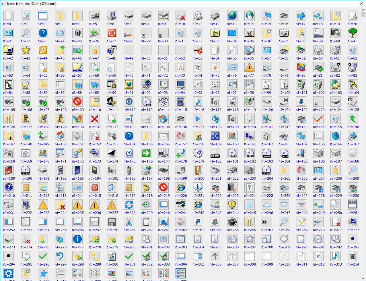

found it : c:\MiniGUI\SAMPLES\BASIC\ExtractIcon\demo2.prg :D
i found in c in c:\MiniGUI\SOURCE\c_icon.c
// HICON ExtractIcon( HINSTANCE hInst, LPCTSTR lpszExeFileName, UINT nIconIndex )
HB_FUNC( EXTRACTICON )
// UINT ExtractIconEx( LPCTSTR lpszFile, int nIconIndex, HICON *phiconLarge, HICON *phiconSmall, UINT nIcons )
HB_FUNC( EXTRACTICONEX )
as i see it use nIconIndex.
Question : how to use it with Resource-ID :?:
nIconIndex 315 = Resource-ID 16826
