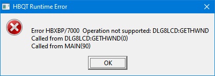

i have Problem with o:GetHwnd() ...

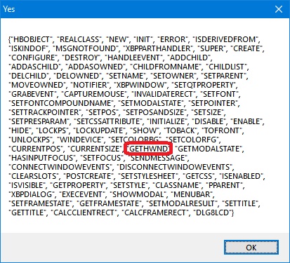

i found __objGetMethodList(Object) and use this Code
82│   oDlg:Show()
83│
84│   xValue := __objGetMethodList(oDlg)
85│   lRet := ASCAN(xValue, {|o| o = "GETHWND"} ) > 0
86│   Msgbox(var2char(xValue),IF(lRet,"Yes","No"))

in Line 85 i search for "GETHWND" and found it.
in Line 89 i test it with __objhasmethod() again and it is .T.
now it crash in Line 90 ... WHY :shock:
do i access GETHWND() in wrong Way (Syntax) :?:
need help please
