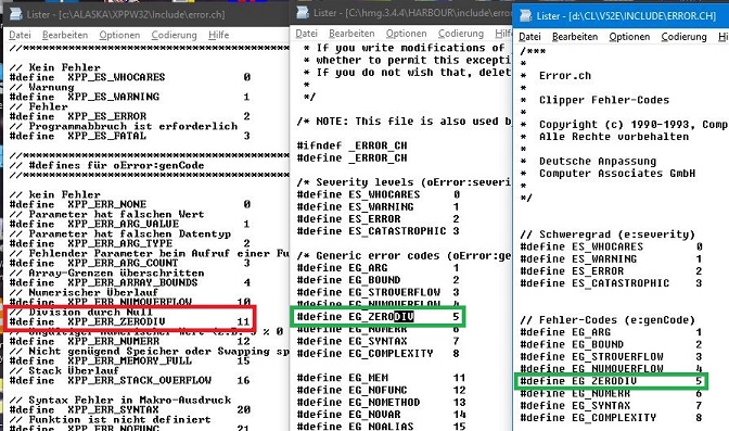

i found c:\hmg.3.4.4\SOURCE\ErrorSys.prg
Question : will that file only work with HMG :?:
it is because this line
   _HMG_SYSDATA [ 347 ] := .F.
i think i can't use my XppError.PRG while Constant are not the same :o
Xbase++
      CASE oError:genCode == XPP_ERR_ZERODIV
      CASE oError:genCode == XPP_ERR_OPEN .AND. ;
      CASE oError:genCode == XPP_ERR_APPENDLOCK .AND. ;
harbour
   IF oError:genCode == EG_ZERODIV
   IF oError:genCode == EG_OPEN .AND. ;
   IF oError:genCode == EG_APPENDLOCK .AND. ;
Code is about same but Constante are different for :genCode ?
Xbase++
   #define  XPP_ERR_ZERODIV         11
   #define  XPP_ERR_OPEN            71
   #define  XPP_ERR_APPENDLOCK      78
   #define  XPP_ES_FATAL            3
   #define  XPP_ES_ERROR            2
   #define  XPP_ES_WARNING          1
harbour
   #define EG_ZERODIV               5
   #define EG_OPEN                  21
   #define EG_APPENDLOCK            40
   // no FATAL
   #define ES_ERROR                 2
   #define ES_WARNING               1
i don't understand why ...

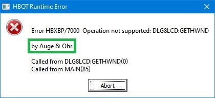

i think i got it :D
i have try to add my Clipper Errorsys but it was not called :(
then i notice Title of Msgbox() have "HBQT Runtime Error".
i have download QT Source but not rebuild yet.
i found c:\hmg.3.4.4\HARBOUR\addons\hbqt\qtgui\hbqt_errorsys.prg and look inside.
PROCEDURE hbqt_ErrorSys()
   ErrorBlock( {| oError | DefError( oError ) } )
so it is a other Name for QT ... :roll:
while Errorsys work i can begin to modify it to get more Information.
