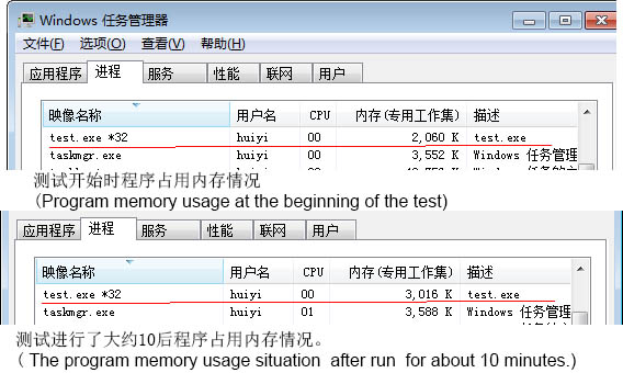

各位大师,你们好,
近日我发现HMG(V3.4.4)中的STATUSBAR控件存在BUG,当我们不停地向STATUSBAR控件赋值时,程序所占有用的内存也在不断地增加!当你打开任务管理器可发现这一现象。请大家帮助我解决这一问题。
Dear masters,
Recently, I found a BUG in the STATUSBAR control in HMG(V3.4.4). When we keep assigning values to the STATUSBAR control, the memory occupied by the program keeps increasing!You can see this when you open task manager. Please help me solve this problem.

Hello guys,
After experiment, StatusBar control memory leak exists only in the Unicode Library of hmg.3.4.4, and no problem is found in the ANSI library of hmg.3.4.4.
