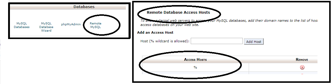

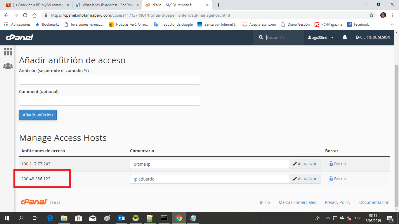

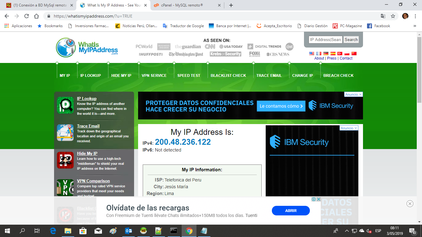

Good morning friends,
I first get my ip address:
Then I configure at cpanel like this
Please confirm me thats ok, so I will call my hosting provider.
Greeting regards,

Re: Conexión a BD MySql remota
Looks OK to me!
Post by zolysoftsolutions »
Try to make this setting in your cPanel.

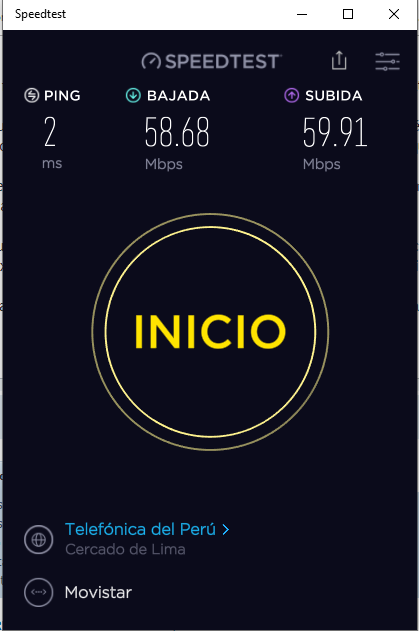

Mi duda ahora es la siguiente, ¿ cual sería el requisito mínimo de ancho de banda que debo solicitar para que mis clientes trabajen optimamente con conexión remota a HOST ?. - Note al subir mi primera tabla que escribir 1,700 registros tomo casi 4 minutos y tengo conexión de fibra óptica de 60mbps.

My question now is the following, what would be the minimum bandwidth requirement that I must request for my clients to work optimally with a remote connection to HOST? - Note when I upload my first table that writing 1,700 records takes almost 4 minutes and I have a 60mbps fiber optic connection.

The answer is not simple. You are trying to create a cloud. If so, take a look at what speeds and flow rates they offer.
I don't know what kind of connection you have, it's usually asymmetrical, here are 50/5 to 300/30, optics.
You should try this query in another way, say with php, and see how, if it works better then do optimization.
One query and application is a big difference, but "every journey starts with a step."
