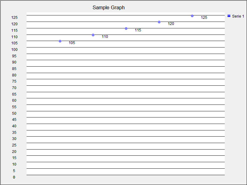

I am from Melbourne, Australia.
I have many years programming in Clipper mainly for my own use - databases for personal and financial details mainly.
I have made several HMG projects successively.
Current problem is a need to make a graph of price data from a DBF file.
I have tried the Bos Tauros samples but having lots of problems with the array functions in them.
The following code is a cut-down version of original - eg, I have eliminated the pie graph option, as well as 3D option etc. to simplify it a bit. Only a sample of the original array declaration works - all other versions do not work.
The other 3 code options all give same error message "DRAW GRAPH: 'Series' / 'SerieNames' / 'Colors' arrays size mismatch." from h_GraphBitmap.prg
I have looked through the many posts re 'BT graphing' but none seem to address the simple point that I am wanting - the ability to draw a graph from a series of datapoints contained in a DBF file.

I would be relieved to know there is a solution to this matter.

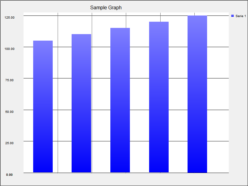

Re: Drawing Graphs from file data
You are welcome aboard!
Please be so kind to try the following updated sample for your option 4:
with a result screen below

RETURN- Attachments
- Graph_Bar2D.PNG (22.12 KiB) Viewed 7129 times

follow one more example
Thanks Grigory & Jair,
I tried Grigory's suggestion and it worked, in that it produced a graph of the points.
However the scaling of the graph is not right, in that all the values are jammed up towards the top of graph. Another problem is there is a vertical black line for every point - I do not need that vertical black line, just horizontal lines to show the Y values.
I have other business to attend to now, will try some more tomorrow. Will also look at Histogram solution, but my requirement is for a point or line solution.
Prof50
Prof50
Hi,prof50 wrote: ↑Tue Mar 05, 2019 9:29 pm However the scaling of the graph is not right, in that all the values are jammed up towards the top of graph. Another problem is there is a vertical black line for every point - I do not need that vertical black line, just horizontal lines to show the Y values.
Please take a look for the updated sample below:

RETURN- Attachments
- Graph_Points2D.PNG (10.56 KiB) Viewed 7034 times
X-Values no longer displayed.
Thanks to Grigory for that.
Now I will work on the scaling problem - perhaps over the coming weekend?
