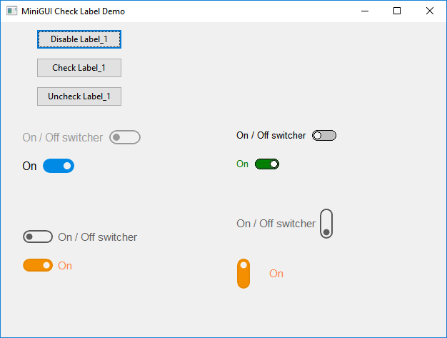

rmtarget wrote: Fri Jan 11, 2019 1:34 am Hola amigos: necesito un botón o control tipo 'flip switch' de On/Off, alguien tendrá un ejemplo de esto o donde lo encuentro ? Gracias !
Hello,
Thanks for your request!
The above control will be available in the MiniguiEx at a next build (please take a look for the attached picture).
Syntax:
@ <row>,<col> SWITCHER <name> [ OF <parent> ] ;
HEIGHT 46 ;
IMAGE { 'MINIGUI_SWITCH_ON', 'MINIGUI_SWITCH_OFF' } ;
[ VALUE <cValue> ] ;
[ FONT <fontname> SIZE <fontsize> ] ;
[ LEFTCHECK ] [ CHECKED ] ;
[ ON MOUSEHOVER <bMouseHover> ] ;
[ ON MOUSELEAVE <bMouseLeave> ] ;
[ ON CLICK <bMouseClick> ]
New SWITCHER control
