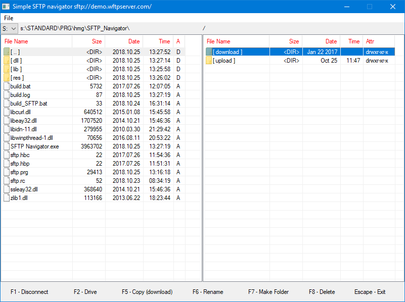

Check out this sample simple application to navigate on an SFTP server.
It only supports basic functions:
- listing of folders / files of local disks and a remote host
- navigating local and remote folders
- copying files (one at a time) from a local disk to a remote folder (upload)
- copying files (one at a time) from a remote folder to a local drive (download)
- renaming files / folders on local disks and on a remote host
- creating folders on local disks and on a remote host
- deleting files and folders from local drives and from a remote host
I tested with a local SFTP server (Bitvise SSH Server 7.46) and with a demo public sftp server: sftp://demo.wftpserver.com/
Authorization with a username and password. I can not authorize using a Public / Private key pair (maybe I have generated it incorrectly or I can not configure it properly, I have no experience with this).
Cheers.

Small improvements:
- when changing the folder to the parent, the active row is set to the name of the folder that you left.
- when adding a new folder, the active row is set on the created folder
- when deleting a file or folder, the active row remains in the nearest position of the deleted item.
- go to the parent folder with the BACKSPACE key.
sftp.7z
(6.63 KiB) Downloaded 373 times

excellent sample! 8-)
thanks for sharing
