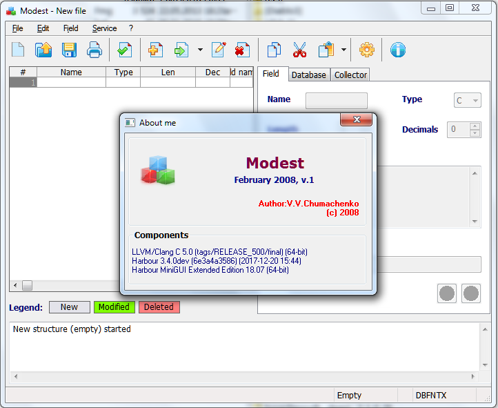

Re: Diferencias HMG 3.x y Minigui
Hello,
It is not a true.
Please take a look for the attached sample 64-bit application (all source codes are included in the Minigui distribution).
- Modest64b.zip
- Modest application
- (1.15 MiB) Downloaded 334 times
- Modest Abour form
- picture.png (64.29 KiB) Viewed 6902 times
