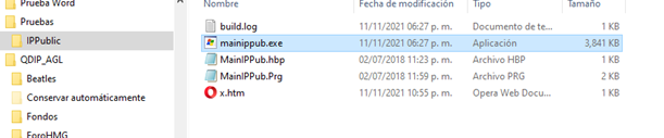

Re: IP Publica
AUGE_OHR wrote: Fri Nov 12, 2021 3:01 am hi,
andyglezl wrote: Tue Jul 03, 2018 5:07 am
HB_FUNC( URLDOWNLOADTOFILE )
  HRESULT hr = URLDownloadToFile(NULL, HMG_parc(1), HMG_parc(2), 0, NULL);
i have try Sample but i got Errpr
undefined reference to `URLDownloadToFileW'
! Note i use Unicode Version
but i don´t understand Error as HB_FUNC is include and it have "A" and "W" of "URLDownloadToFile"
https://docs.microsoft.com/en-us/previo ... dfrom=MSDN
what do i make wrong :?:
Incluiste el archivo MainIPPub.hbp ?
Hace rato lo probé y funcionó.
Did you include the MainIPPub.hbp file?
I tried it a while ago and it worked.
