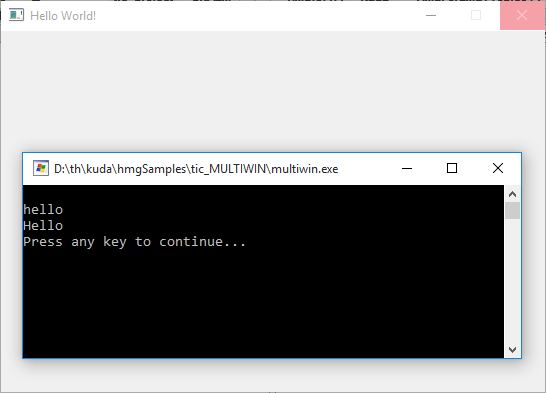

Dear Friends,
Is it possible to have a form with console panel inside ?
Form with console panel inside
TIA
best rgds,
Chang

Chang, you can try in this way:
REQUEST HB_GT_WIN_DEFAULT
MEMVAR _HMG_SYSDATA
FUNCTION Main()
  DEFINE WINDOW MainForm;
    WIDTH  700;
    HEIGHT 500;
    MAIN;
    ON INIT  MainFormOnInit();
    ON PAINT RedrawWindow(GetConsoleWindow())
    DEFINE BUTTON WriteButton
      ROW     430
      COL     10
      WIDTH   130
      HEIGHT  25
      CAPTION "Write in console"
      ACTION  WriteInConsole()
    END BUTTON
  MainForm.CENTER
  MainForm.ACTIVATE
FUNCTION MainFormOnInit()
  LOCAL nHWndConsole := GetConsoleWindow()
  IF nHWndConsole != 0
    IF SetParent(nHWndConsole, MainForm.HANDLE) != 0
      SetMode(25, 80)
      SetWindowPos(nHWndConsole, 0, 10, 10, 0, 0, 0x15 /*SWP_NOACTIVATE|SWP_NOZORDER|SWP_NOSIZE*/)
      RedrawWindow(nHWndConsole)
    MainForm.WriteButton.SETFOCUS
    ? "0"
FUNCTION WriteInConsole()
  STATIC n := 0
  IF GetConsoleWindow() != 0
    ? HB_Ntos(++n)
#pragma BEGINDUMP
#include <windows.h>
#include "hbapi.h"
#include "HMG_UNICODE.h"
HB_FUNC( GETCONSOLEWINDOW )
  HMG_retnl((LONG_PTR) GetConsoleWindow());
#pragma ENDDUMP

Thanks KDJ,
it works but it seem that I cannot activate/type the console as usual ?
Anyway to work around ? or can we have it function like a DOS Shell ?
TIA
best rgds,
Chang
