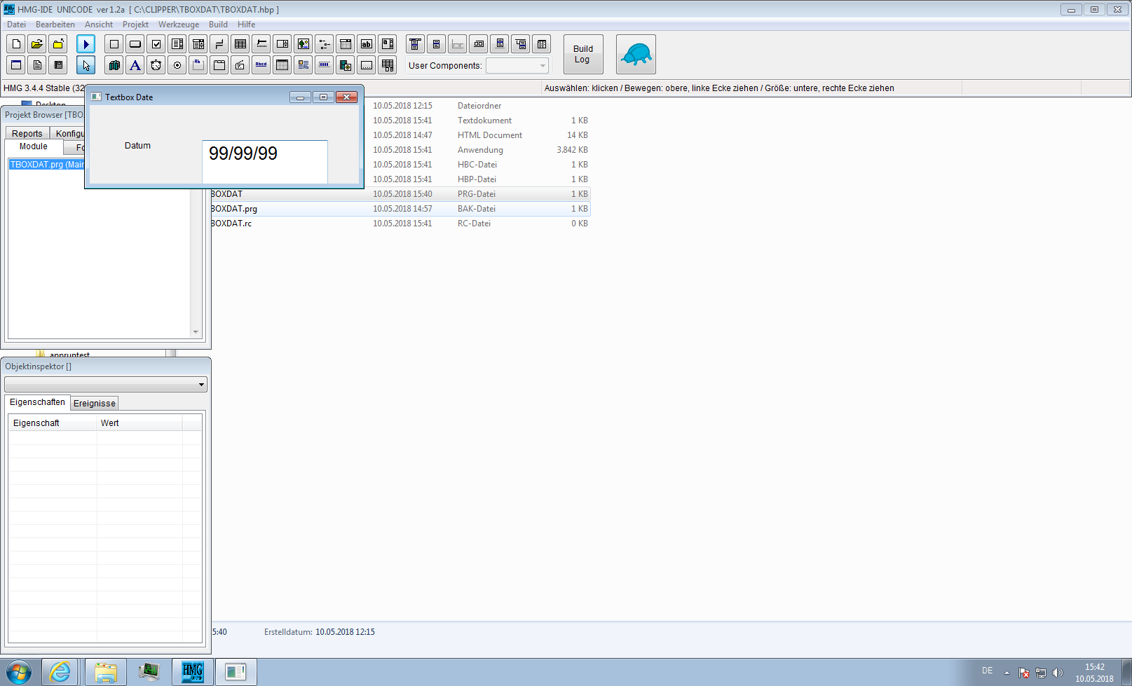

Hi friends,
I played around with a date-type textbox and need help. See the code:
set century on
set date to german
set date format to "DD.MM.YYYY"
FUNCTION Main()
local cDat, cDatum
 DEFINE WINDOW Date_1 ;
 AT 120,120 ;
 WIDTH 400 ;
 HEIGHT 150 ;
 TITLE "Textbox Date" ;
 MAIN
 On Key F10 of date_1 action showdat()
 @ 50,50 LABEL datum ;
 PARENT Date_1 ;
 VALUE "Datum" ;
 @ 50,160 TEXTBOX date ;
   PARENT Date_1 ;
   WIDTH 120 ;
   HEIGHT 30 ;
   date
   inputmask "99.99.9999"
   VALUE Date()
 ACTIVATE WINDOW Date_1
 function showdat
 cDat:=dtoc(Date_1.date.value)
 cDatum:=right(cDat,4)+substr(cDat,4,2)+left(cDat,2)
 MsgInfo(cDat)
 MsgInfo(cDatum)
return
It seems inputmask does not work with date-textbox, and the date format setting is ignored too.
Btw: Why do I not get a syntax error because of the semicolon at value of label datum and why do I get a syntax error at the date statement in textbox?
Thank you for your help
Robert
PS: How can I append a screenshot to show you the result of my code?

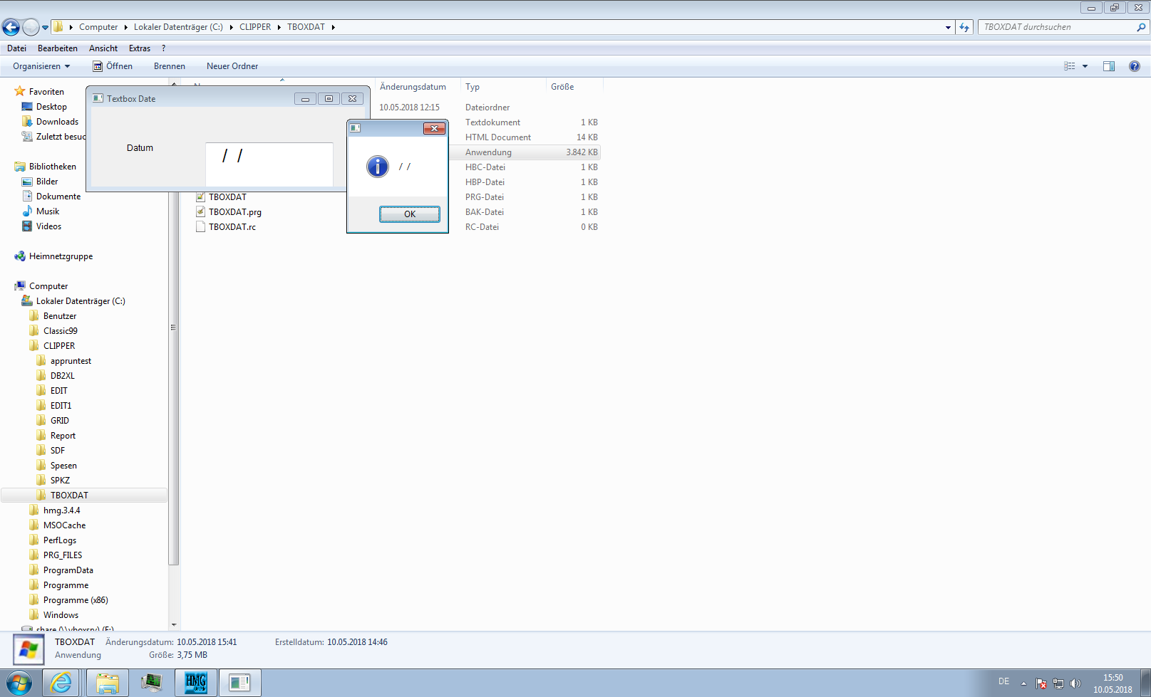

As you can see from the attached screen shot, the typed in date is not validated, but the MsgInfo shows nothing (blank).
The sequence of the attached files is wrong. Sorry for that.
