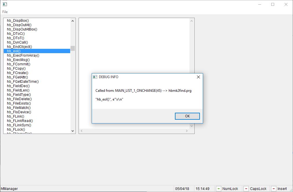

Dear Friends,
I need help on the error trapping,
This works with no errors
error is not trapped
the code,
