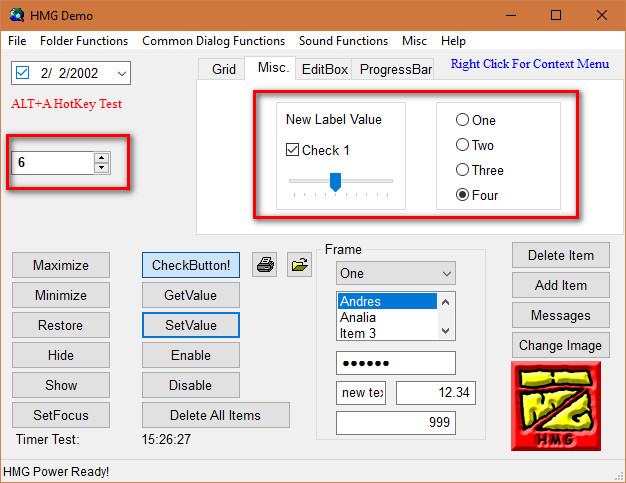

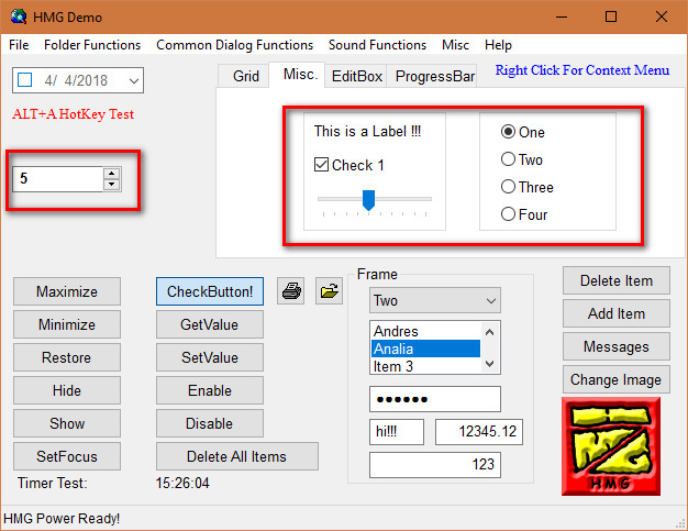

Hi Alan,
I suggest you try HMG\SAMPLES\Basics\MAIN_DEMO\
When you press "SetValue" button, you will note that the label (say in clipper), textbox (get in clipper) has changed.
See screen shot attached.
So basically we do not use different textbox in same space, but change the value of the textbox and use the same object. Though you can create a new textbox in same place and it will work, but not advised for memory sake.
Anand
