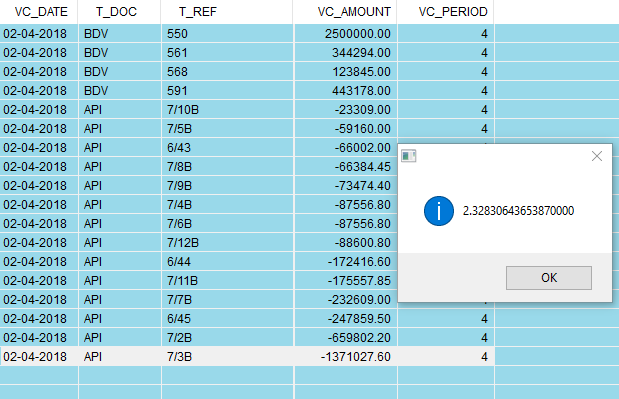

I have a table with a 'debit', 'credit' and 'balance' columns, all type float. The balance column stores a debit-credit and therefore has a mix of positive and negative entries. The problem I have is sqlite sum is sometimes giving incorrect totals, which can cause one to incur financial loses.
Has anyone got an idea how to resolve this?,

The table:
CREATE TABLE `Vclear` (
`T_TYPE` VARCHAR ( 3 ),
`T_DOC` VARCHAR ( 4 ),
`T_REF` VARCHAR ( 20 ),
`T_DATE` DATE ( 8 ),
`T_STAMP` VARCHAR ( 20 ),
`VC_TYPE` VARCHAR ( 10 ),
`VC_DATE` DATE ( 8 ),
`VC_STAMP` VARCHAR ( 15 ),
`VC_PERIOD` FLOAT ( 2 , 0 ),
`ACCOUNT_CODE` VARCHAR ( 20 ),
`VKEY_CODE` VARCHAR ( 20 ),
`VKEY_INFO` VARCHAR ( 40 ),
`VC_AMOUNT` FLOAT ( 15 , 2 ),
PRIMARY KEY(`T_DOC`,`T_REF`,`T_STAMP`,`VC_STAMP`,`ACCOUNT_CODE`,`VKEY_CODE`)
The querry:
SELECT TOTAL(vc_amount) FROM Vclear;
The data is as below,...the expected result is Zero, not 2.32830643653870000

SUM or TOTAL have the same result have the same result. The following statement seems to work,...
SELECT ROUND(TOTAL(VC_AMOUNT),4) FROM Vclear
Not sure it will work for every situation though,...as Dragancesu observes above, it is a big problem in sqlite. Do other sqls have this problem i wonder,...it can be a very big problem when designing applications dealing with money

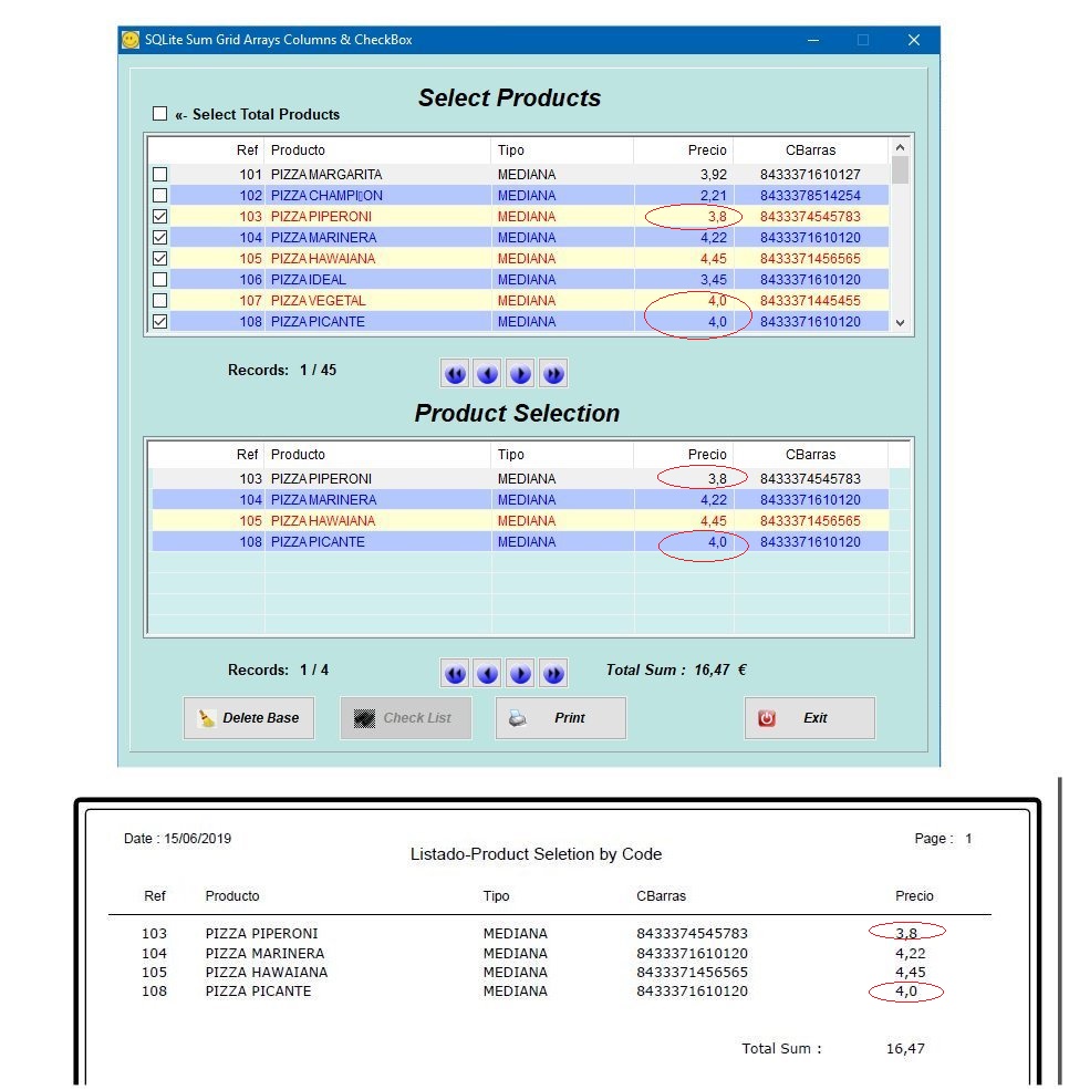

Hola amigos:
Siguiendo con los experimentos con SQLite
La suma de cantidades económicas de precios.
No consigo que en los GRID y en el Listado PDF
las cantidades económicas que terminan en "0"
salgan , vean la muestra sale 3,8 cuando tendía
que ser 3,80 ó 4,0 cuando tendría que ser 4,00
el problema de la "," de los Euros no es el problema
porque si no se aplica STRTRAN ( precio , '.',',')
sale lo mismo falta el "0"
También he aplicado --> ROUND( precio, 2 ) , indicando
que son 2 decimales, solo pasa con los "0" ?
Si alguien puede indicar alguna solución, agradecido
Un cordial saludo.
