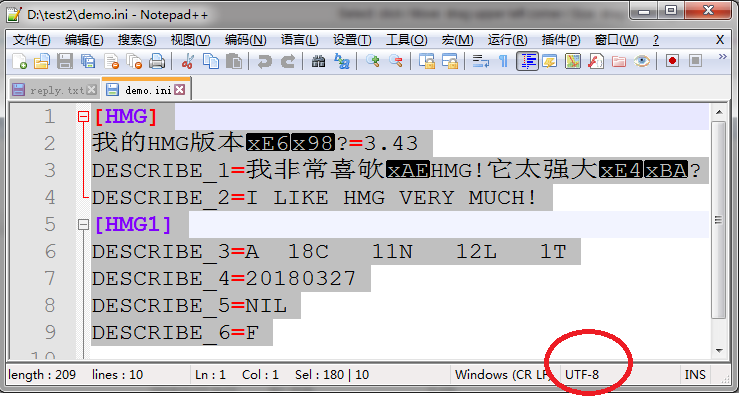

huiyi_ch
Posts: 173
Re: INI files handling exists BUG
Post by huiyi_ch »
Hello EDK.
First of all, thank you for your reply in time!

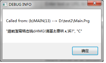

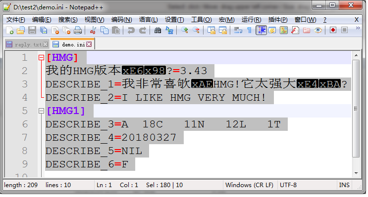

I have preliminarily tested your patch, which is normal when hmg-Unicode does not set CODE PAGE. But if CODE PAGE is set up, Some unknown characters will appear in the result of the program running. See an example:

display value of DESCRIBE_1
demo.ini
demo.ini
edk
Posts: 999
Post by edk »
Hey.
It seems to me that this is not the fault of my patch, because it only improves the collection of values from the INI file.
There is a problem here at the stage of creating the INI file.
Please note that the source file of prg is probably encoded in UNICODE (UTF-8). In your code, however, you have defined the GBK Simplified Chinese code page:
hb_CdPSelect("GBK")
You are trying to save the characters string hardcoded in UTF-8 into the INI file that will be encoded in GBK.
See what happens if you convert a string from UTF-8 to GBK before saving it to the INI file?
 SET SECTION 'HMG'  ENTRY 'DESCRIBE_1' TO hb_Utf8ToStr( "我非常喜欢HMG!它太强大了" )
You can also try to save the prg file in the GBK code page, then you do not do character conversion.
I tested on the Polish ISO code page and it seems to me that it works correctly.
