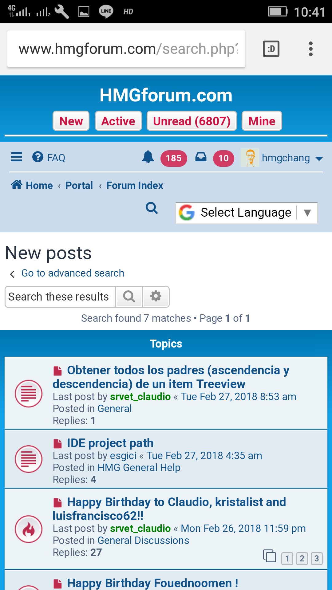

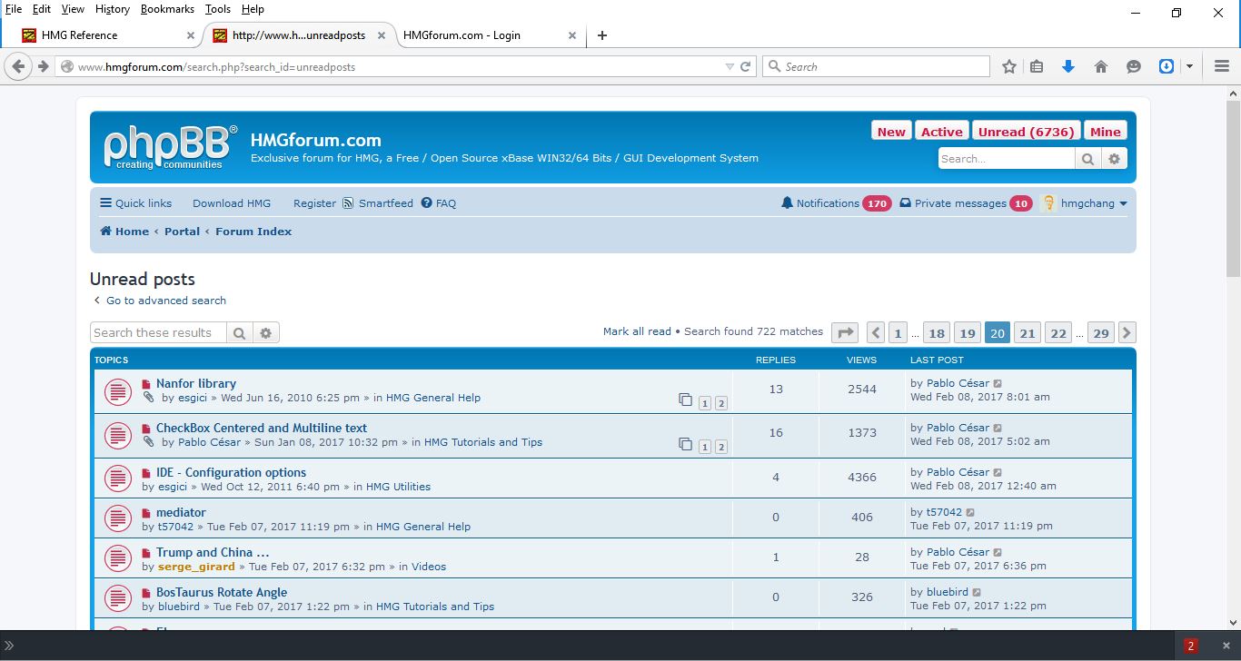

Dear All,
As can be seen i hv 6807 unread topics.
So i want to code with hmg in order to save all the unread posts. Without the browser

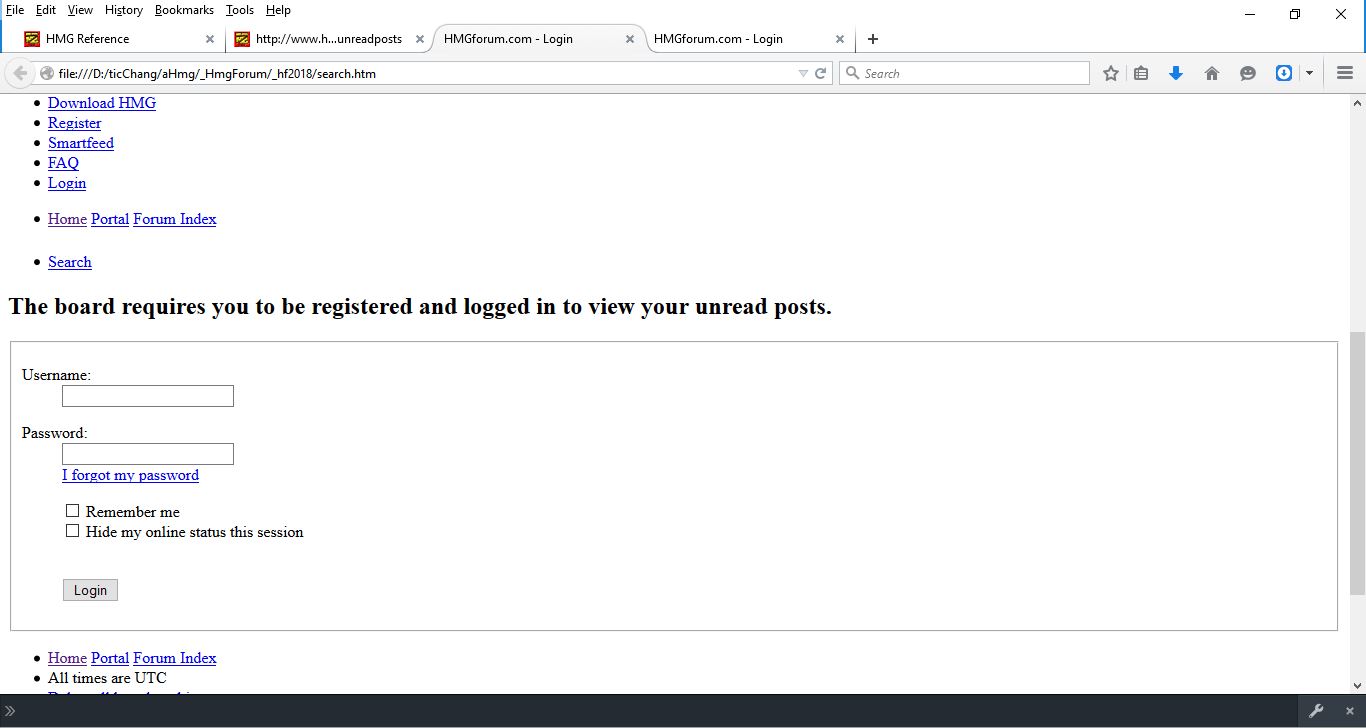

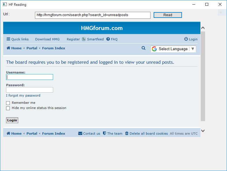

now even worse :
this is what you see :
after this page saved as ( complete html), and opened offline with your browser,
this is what you get :
:roll:
it seem after 'capcay' and 'keong racun'... :lol:
pls spare me... :roll:
TIA
best rgds
Chang

I don't think it's possible to omit login screen.
Everytime you log in to the forum, you get session id. If you do not use forum for few minutes, this session id dies and you need to log in again.
This session id is passed by php scripts from start page to the next.
Re: Access to HmgForum unread posts
Posted: Thu Apr 05, 2018 2:01 pm
Rightly said Marek.
Sorry I didn't see this topic previously.
You have to use the sessionid to move into the member area of phpbb forum.
I can give you a clue: You can grab the sessionid once you know the username and password using curl.

Last month i can save my unread posts by pressing the Ctrl-S ( Mozilla) and read it offline
Now.... pressing Ctrl-S to save the page but when offline all i can read is the login page :?: :?: :?:
its a sophisticated master skill to do that... salute...
