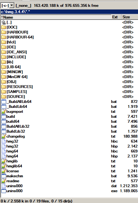

Re: Installing 64 bit HMG with 32 bit already working
Better an image than a hundred words.
I installed as you said. My c:\HMG3.4.4 directory has the same folders as yours does ***except**** I am missing the folder named OBJ. Also I am getting messages that HBMK2 is not recognized.
Well my OBJ folder are empty ... LOL
