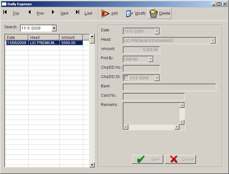

I added print option with daily expense entry:-
I created this with help from Rathinagiri's GridPrint library with HFCL. Thank you Rathi for this excellent tool :D
Now, I'm not able to use GridPrint's semi-opp syntax. But, I am sure next time I can use it.
Thanks you Esgici for your excellent support (I know how I got help from you when I was totally depressed) :D
