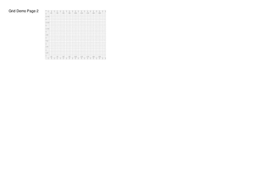

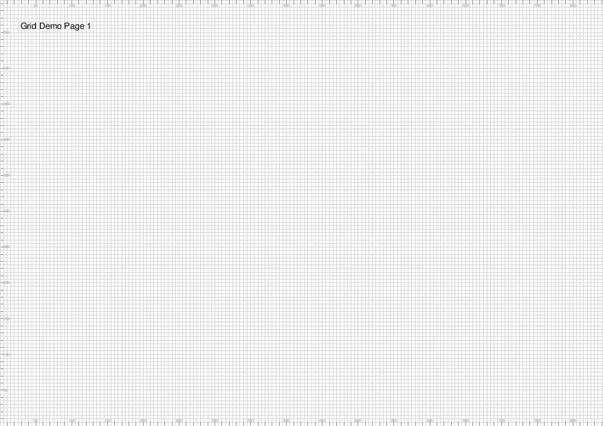

Here you are, anything else :?:
Function Main()
Local i, lSuccess
SELECT HPDFDOC "sample.pdf" TO lSuccess ORIENTATION HPDF_ORIENT_LANDSCAPE PAPERSIZE HPDF_PAPER_A4
SET HPDFDOC ENCODING TO "WinAnsiEncoding"
START HPDFDOC
    START HPDFPAGE
	print_grid( 0, 0, HPDF_Page_GetHeight (_HMG_SYSDATA[ 150 ][ 7 ]), HPDF_Page_GetWidth (_HMG_SYSDATA[ 150 ][ 7 ]), 5, 5, 50 , 50 , 10 , 10 )
	@10,10 HPDFPRINT "Grid Demo Page 1"
    END HPDFPAGE
    START HPDFPAGE
	@10,10 HPDFPRINT "Grid Demo Page 2"
	print_grid( 400, 150, 160, 200, 5, 5, 20 , 20 , 10 , 10 )
    END HPDFPAGE
END HPDFDOC
IF lSuccess
   Execute File 'sample.pdf'
Function print_grid( nRow, nCol, height, width, nScaleLine_X, nScaleLine_Y, nScaleText_X, nScaleText_Y, nTag_x, nTag_Y )
   Local  font,x,y, cLabel, nLabWidth
   Local Pdf        := _HMG_SYSDATA[ 150 ][ 1 ]
   Local Page       := _HMG_SYSDATA[ 150 ][ 7 ]
   Local nFontSize   := 5
    font = HPDF_GetFont (pdf, "Helvetica", Nil)
    HPDF_Page_SetFontAndSize (page, font, nFontSize)
    HPDF_Page_SetGrayFill (page, 0.5)
    HPDF_Page_SetGrayStroke (page, 0.8)
    /* Draw horizontal lines */
    y := 0 // distabcia inicio primeira linha
    while (y <= height )
        if  (y % (nScaleLine_Y*2) == 0)
            HPDF_Page_SetLineWidth (page, 0.5)
           if (HPDF_Page_GetLineWidth (page) != 0.25)
              HPDF_Page_SetLineWidth (page, 0.25)
           Endif
        Endif
        HPDF_Page_MoveTo (page, nCol, y + nRow)
        HPDF_Page_LineTo (page, width + nCol, y + nRow)
        HPDF_Page_Stroke (page)
        if (y % nTag_Y == 0 .and. y > 0)
            HPDF_Page_SetGrayStroke (page, 0.5)
            HPDF_Page_LineTo (page, nScaleLine_Y + nCol , y + nRow)
        Endif
        y += nScaleLine_Y
    End
    /* Draw vertical lines */
    x := 0 //distabcia inicio primeira linha
    while (x <= width)
        if (x % (nScaleLine_X*2) == 0)
            Endif
        Endif
        HPDF_Page_MoveTo (page, x + nCol, nRow)
        HPDF_Page_LineTo (page, x + nCol, height + nRow)
        if (x % nTag_X == 0 .and. x > 0)  // linha de referencia com a tag texto linha mais forte
            //tag esquerda
            HPDF_Page_LineTo (page, x + nCol, nScaleLine_X + nRow )
            //tag direita
	    HPDF_Page_MoveTo (page, x + nCol, height + nRow)
            HPDF_Page_LineTo (page, x + nCol, height - nScaleLine_X + nRow)
        Endif
        x += nScaleLine_X
    End
    /* Draw horizontal text */
    y := 0 //distabcia inicio texto
    while (y < height)
        if (y % (nScaleText_Y) == 0 .and. y > 0)
	    cLabel:=ltrim(str(y))
            HPDF_Page_BeginText (page)
            HPDF_Page_MoveTextPos (page, nScaleLine_Y + nCol, y + nRow - (nFontSize/2) + .75  /* Middled Label */)
            HPDF_Page_ShowText (page, cLabel)
            HPDF_Page_EndText (page)
        Endif
        y += nScaleText_Y
    End
    /* Draw virtical text */
    x := 0
    while (x < width)
        if (x % (nScaleText_X) == 0 .and. x > 0)
            cLabel:=ltrim(str(x))
	    nLabWidth:=HPDF_Page_TextWidth( page, cLabel )
            //tag em baixo
            HPDF_Page_MoveTextPos (page, x + nCol - (nLabWidth/2)  /* Centered label */, nScaleLine_X + nRow + 1)
            //tag em cima
            HPDF_Page_MoveTextPos (page, x + nCol - (nLabWidth/2)  /* Centered label */, height - (nScaleLine_X * 2) + nRow)
        Endif
        x += nScaleText_X
    End
    HPDF_Page_SetGrayFill (page, 0)
    HPDF_Page_SetGrayStroke (page, 0)

exactly that edk, only one doubt (nRow = 400) and the sheet is A4 has 210mm nRow = 400 (pixel)?

Haru Pdf is based on pixels for default resolution 72dpi. Also note the coordinates that are different from HMG HPDF.
http://libharu.sourceforge.net/graphics.html
So 210mm is: 210/25.4 * 72 = 595,275591 px
and 297mm is: 297/25.4 * 72 = 841,889764 px
Look at grid on page 1.
At sample on page 2, value 400 corresponds lower-left corner of the grid in pixels (nRow), so 400/72 * 25.4 = 141,111111 mm, counting from bottom of the page.
