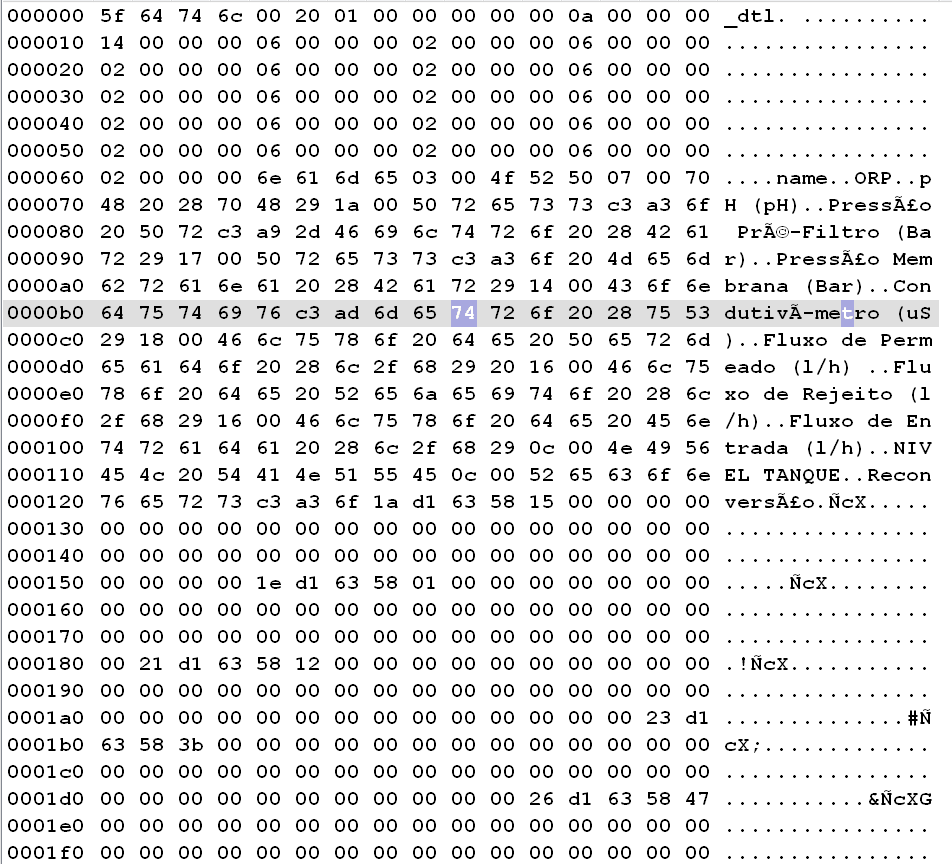

Hello KDJ you are reading the file size this is not an error, it will only give an error when trying to read the contents of the file that would be what I need to follow, an example of what is inside the file, I need to import this into a grid

Serge,
This is a .DTL file.
I'm afraid that with EDITBOX you will not get anything, neither with FREADSTR() or similar low-level functions.
It would be necessary a tool that would make the contents of the file something readable.

Re: read binary file with fopen
Absolutely right !
Browsing works with Free Hex Editor Neo.
