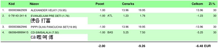

I needed to help with HPDFPRINT UNICODE
If I use HPDFPRINT the background color remains
For HPDFPRINT UNICODE is white
Source
@ Px-1.10 HPDFPRINT RECTANGLE to px + 5-1,205 color {c1, c2, c3} filled
@ Px, 10 HPDFPRINT str (i_pria, 3.0) + '.' To px, 16 FONT "Helvetica" SIZE 7
@ Px + 4-1,10 HPDFPRINT RECTANGLE to px + 10-1,205 color {c1, c2, c3} filled
@ Px + 3, 37 HPDFPRINT UNICODE s_nach to px + 9, 88 FONT "ArialUni" size 9
Thank you for your help
HPDFPRINT UNICODE Background color

Re: HPDFPRINT UNICODE Background color
Hi.
In fact, the UNICODE text in HPDF is a graphic.
See function _HMG_HPDF_MULTILINE_PRINT_UNICODE() in the source "h_HMG_HPDF_UNICODE.PRG"
The background color of the image is set to WHITE rigidly.
You can try to do your own function based on this source to add an additional parameter as the background color.
Thanks for help
I have adapted this feature
I have to change the names of functions in "hmg_hpdf.ch"
