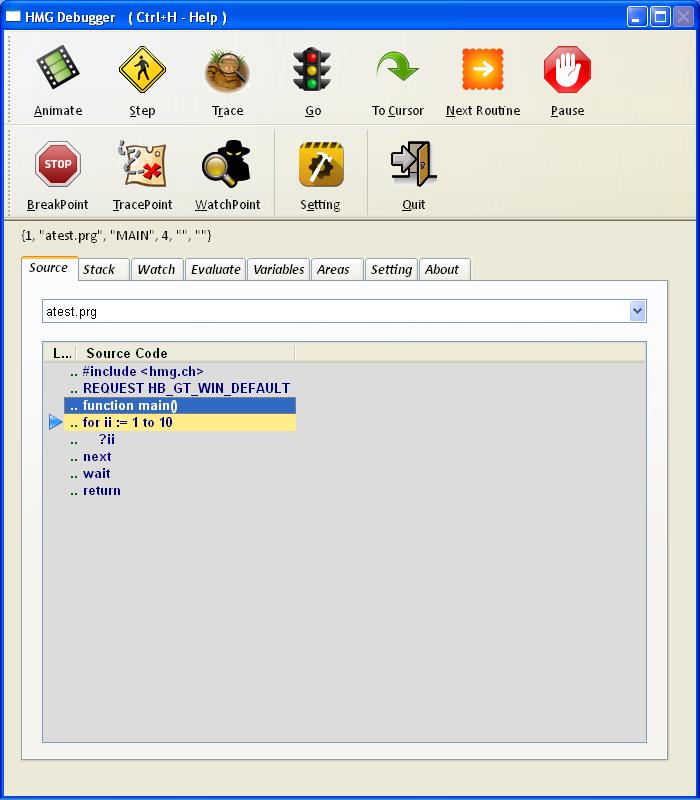

I am facing compilation error every time I try to compile any code after function main() line!
The same program compiles properly on Windows 10 PC.
Can any one help to overcome the error?
Best Regards
Mahfuz
Best Regards
Mahfuz
- error.JPG (62.28 KiB) Viewed 6631 times

mahfuzmurshed
- Posts: 10
- Joined: Wed Jul 05, 2017 5:14 am
Re: Compilation error on Win XP PC
It also works for me when I compile and run it in Windows 10.
I have already send screen shot which I have got when I try to run the program. The interesting thing that any thing I write after function main() it stops there and show the screen I already send.
There is no error message I found! Simply the program stops at that line and if I click on Step button the a message "Invalid code" with the line number appears!
I am very confused what can I do to overcome this problem.
It's on hmg 3.4.4? You have compiled with debugger. Try without debugger.

mahfuzmurshed
- Posts: 10
At last I have found the solution!!!
I found in the build.bat file the following line:
Build [ /n ] [ /d ] [ /c ] <program.prg> | <project.hbp> [<hbmk2 params>]
Then I studied the switches of hbmk2 and found a switch -b[-] which will enable/disable the debugger.
So, I use -b- switch at the end of my command line e.g. build /n /c test -b-
Thanks everyone who try to help me and also I think my solution may help others to overcome run time debugger problem.
Best Regards
Mahfuz
Best Regards
Mahfuz
