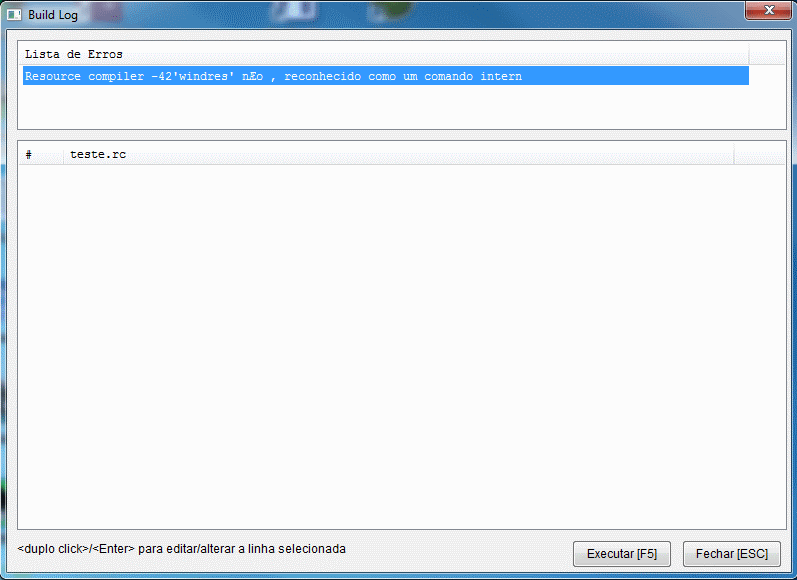

Re: Form main is locking application close (not responding)
Full install now does not compile ide ansi menu 64 bits
build.log
hbmk2: Compilando...
hbmk2: Linkando... teste.exe
gcc.exe: error: .hbmk/win/mingw64/_hbmkaut_Main.o: No such file or directory
hbmk2[teste]: Erro: Executando linkeditor. 1
gcc.exe .hbmk/win/mingw64/Main.o .hbmk/win/mingw64/_hbmkaut_Main.o "E:/@Prog-Xbase/@Projetos/@MySQL/SISTEMAS/teste/_temp.o" -pthread -static-libgcc -static-libstdc++ -static -lpthread -mwindows -Wl,--start-group -l"hmg-64" -l"crypt-64" -l"edit-64" -l"editex-64" -l"graph-64" -l"ini-64" -l"report-64" -l"hfcl-64" -lmsvfw32 -lvfw32 -l"hbvpdf-64" -lhbct -lhbwin -lhbmzip -lminizip -lhbmemio -lhbmisc -lhbtip -lsqlite3 -lhbsqlit3 -lsddodbc -lrddsql -lhbodbc -lodbc32 -lhbhpdf -lhbnetio -lxhb -lpng -llibhpdf -lhbzebra -lhbextern -lhbdebug -lhbvmmt -lhbrtl -lhblang -lhbcpage -lgtcgi -lgtpca -lgtstd -lgtwin -lgtwvt -lgtgui -lhbrdd -lhbuddall -lhbusrrdd -lrddntx -lrddcdx -lrddnsx -lrddfpt -lhbrdd -lhbhsx -lhbsix -lhbmacro -lhbcplr -lhbpp -lhbcommon -lhbmainwin -lkernel32 -luser32 -lgdi32 -ladvapi32 -lws2_32 -liphlpapi -lwinspool -lcomctl32 -lcomdlg32 -lshell32 -luuid -lole32 -loleaut32 -lmpr -lwinmm -lmapi32 -limm32 -lmsimg32 -lwininet -lhbpcre -lhbzlib -Wl,--end-group -oteste.exe -L"C:/hmg.3.4.4_x64/harbour-64/lib/win/mingw64" -L"C:/hmg.3.4.4_x64/lib-64"
Removed the line in config inc = yes compiled but it takes the same delay to close the main window
