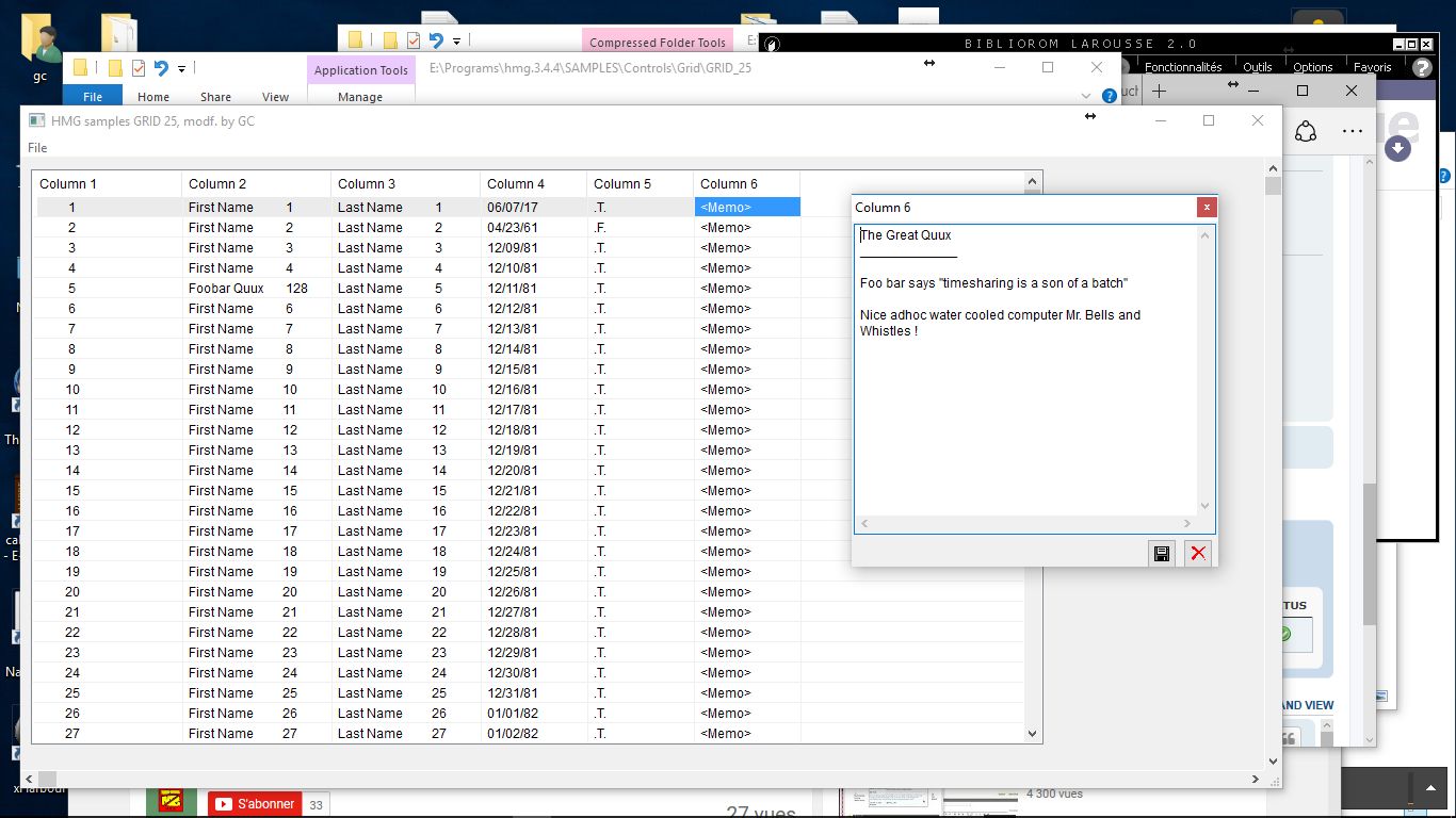

I am using the GRID_25 sample of the HMG 3.4.4 distrib, the code in the demo.prg file was written by Roberto Lopez in 2009, perhaps things have changed a bit since and it was working then, but now when I launch the exe (the compilation works fine) and I click on the last (6th) field, which is a memo field (controlled by the GRID control
aCtrl_6 := { 'EDITBOX' }
) then :
1. I type a sample text and save it
2. When I re-click on the same memo field, the changes seem not to be saved
3. I quit the program and go to view the DBF (TEST.DBF included in the "hmg.3.4.4\SAMPLES\Controls\Grid\GRID_25" folder) using LibreOffice Calc (which can smoothly open DBF files) I can clearly see that my changes HAVE BEEN SAVED
4. I restart the GRID_25\demo.exe and the memo field I modified (and just checked through LO-Calc) seems empty / does not show its contents.
Can someone tell me what I do wrong or what I would need to modify in the 2009 code of the GRID_25 sample to use it now with this version of HMG.
My OS : W10 Pro 64. Compile HMG in 32 bits.
I hope someone of the group can help me.

What you have reported is a bug and thank you for reporting.
Now, you can do any of the following:
1. Plesae modify the line number 1133 of \hmg.3.4.4\source\h_grid.prg
from
	     cTextFile:= GetDataGridCellData ( idx , .t. )
to
	     cTextFile:= v  // GetDataGridCellData ( idx , .t. ) By Rathinagiri June 2017
and rebuild the library by running the batch file \hmg.3.4.4\buildlib32.bat
2. Download the updated library which is attached here and copy the same to \hmg.3.4.4\lib folder.
libhmg.zip
(506.05 KiB) Downloaded 350 times

Woaw Rathinagiri, you are my God! :)
As I am both lazy and a coward I choose option to download your fixed library and copy it in the lib folder after renaming the original.
After GRID-25 program recompiled, your bug fix worked perfectly for me, now I can see the memo (I save the memo using the "floppy disquette" icon at the bottom of the memo window, then the whole record changes using "file/save pending") each time I click on it.
Changes are saved from one run to another. Look :
