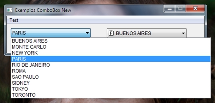

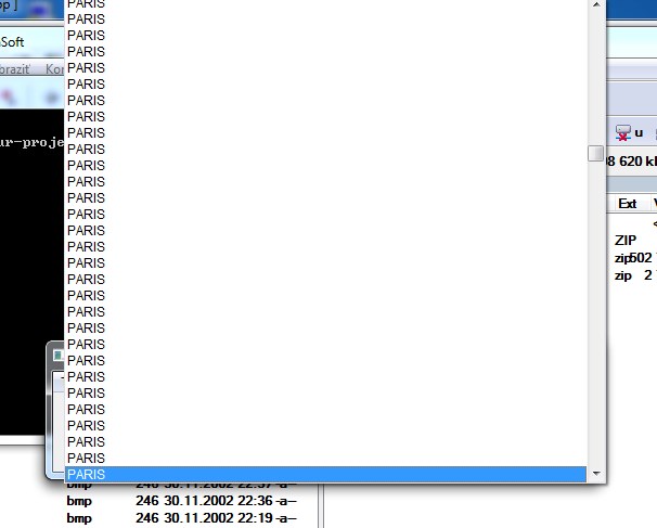

Function does not accept the HEIGHT parameter
records must be more than just going into the window
I used a standard demo
and canceled the array with images
d:\hmg344\SAMPLES\Controls\ComboBox\COMBO_8\
used OS W7 Profi 32bit
in win XP SP3 works well
- COMBO_8.ZIP
- source with a greater dbf
- (16.59 KiB) Downloaded 295 times
- correct viewing
- Screenshot_2.jpg (35.22 KiB) Viewed 8270 times
- inorrect viewing
- Screenshot_1.jpg (40.34 KiB) Viewed 8270 times

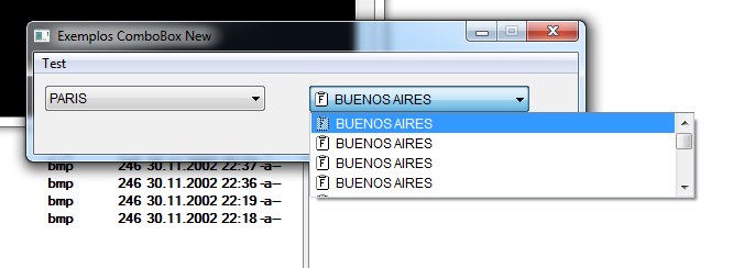

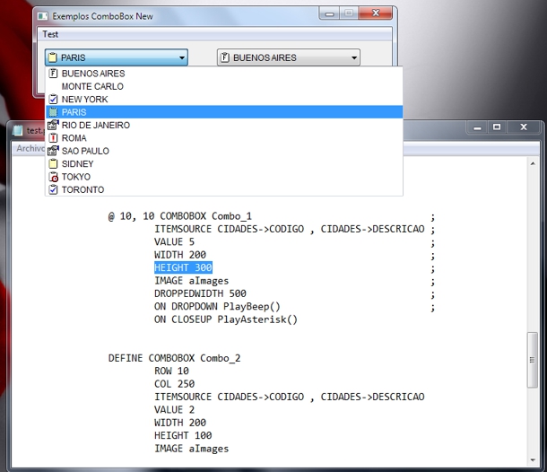

Re: Combobx control
Probado en W7 PRO 32bits y funciona OK.
Pareciera que tu archivo de indices está mal.
el HEIGHT solo muestra las ciudades que hay en el dbf, pudieras añadir mas.
Tested on W7 PRO 32 bit and works OK.
It looks like your index file is wrong.
The HEIGHT only shows the cities that are in the dbf, you could add more.

Re: Combobx control
Thank you for your response
Bust please use the database I sent
It will not be in the index, I deleted it before running it.

Re: Combobx control
Sorry, Georg,
I didn't understand your question right.
As far as I remember, there was somewhere in our forum a clarification, that the HEIGHT property applies to the height of the initial box of the combobox only and not to the height of the expanded dropdown list.
Unfortunately, I can not give here the exact link.
Marin
Marin
