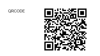

Hello Andrés.
I think this is a bug. My procedure for generating QRCODE codes directly in PDF and also based on hb_zebra library generates your QR code correctly.
In my spare time I will try to look at the sources in h_HMG_Zebra.Prg
Function Main()
SELECT HPDFDOC "sample.pdf" PAPERLENGTH 300 PAPERWIDTH 300 LOG
SET HPDFDOC ENCODING TO "WinAnsiEncoding"
START HPDFDOC
START HPDFPAGE
@10, 10 HPDFPRINT "QRCODE"
HPDFDrawBarcode(10, 50, "RFC-Emisor|RFC-Receptor|12345.00|20172106-3164-5644-225876345685|", "QRCODE", 4)
END HPDFPAGE
END HPDFDOC
Execute File 'sample.pdf'

Re: QR Code in HMG
I found a bug in h_HMG_Zebra.Prg
You must change at FUNCTION HMG_Zebra_GetWidth and FUNCTION HMG_Zebra_GetHeight:
to
Then rebuild hmg.
hb_zebra_draw ( hZebra, {| x, y, w, h | nBarWidth:=x+w-x1, nBarHeight:=y+h-y1 }, x1, y1, nLineWidth, nLineHeight, iFlags )Code: Select all
hb_zebra_draw ( hZebra, {| x, y, w, h | nBarWidth:=MAX(x+w-x1, nBarWidth), nBarHeight:=MAX(y+h-y1, nBarHeight) }, x1, y1, nLineWidth, nLineHeight, iFlags )
