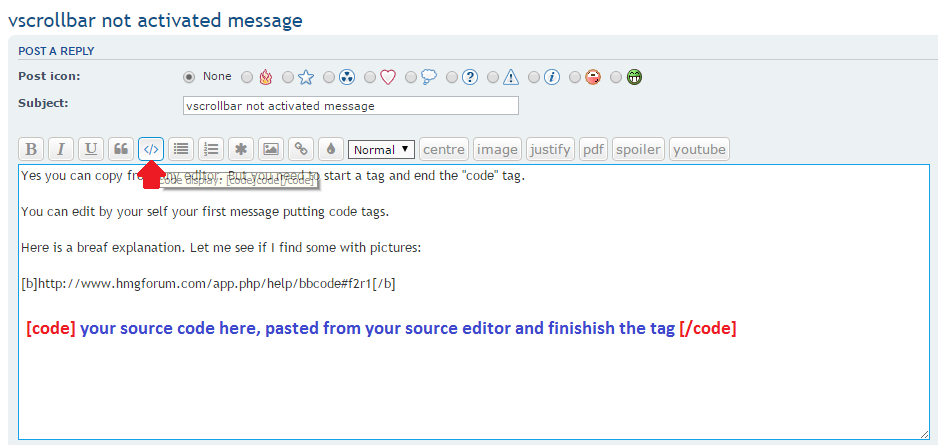

Yes you can copy from any editor. But you need to start a tag and end the "code" tag.
You can edit by your self your first message putting code tags.
Here is a brief explanation.
app.php/help/bbcode#f2r1

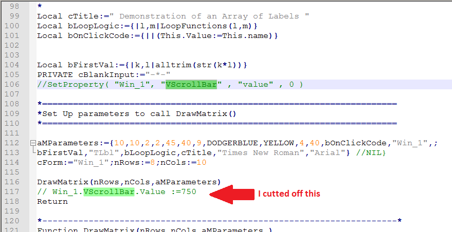

I got compiling without error cutting off VScrollBar new assigning.

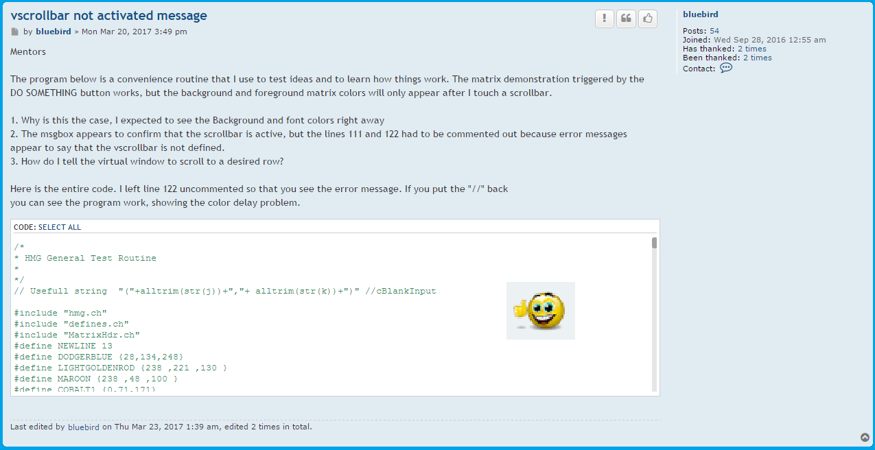

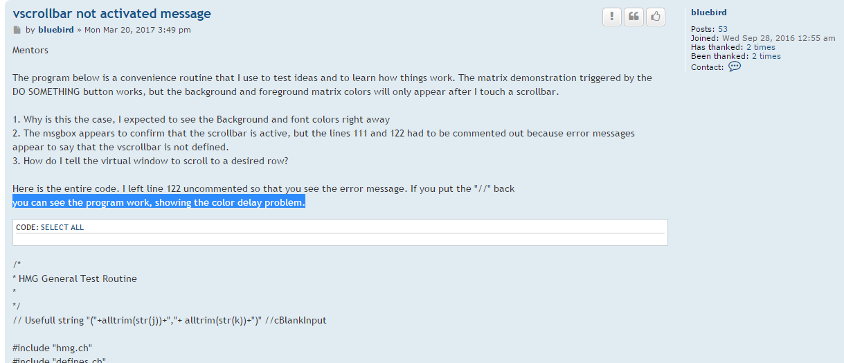

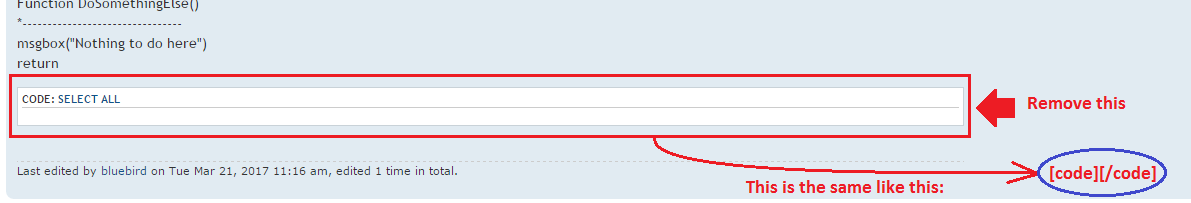

Please re-edit your first message again.
  1. Check in your editing msg the line after as it is here by the selected in blue backcolor (see pic below)
  2. You will see something like this:
  3. By selecting block and cut it by the edit-command Ctrl X the part be selected and cutted is  [/code] (see in red color)
  4. Make position with cursor at final of your code and paste on it with the edit-command Ctrl V
  5. Remove where is "code" and slash "code" at end of your message that you have duplicated:
  6. Submit your message. That's all...
Following by the exactly I've described, you will get your source-code braced in CODE TAGs.
