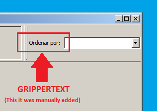

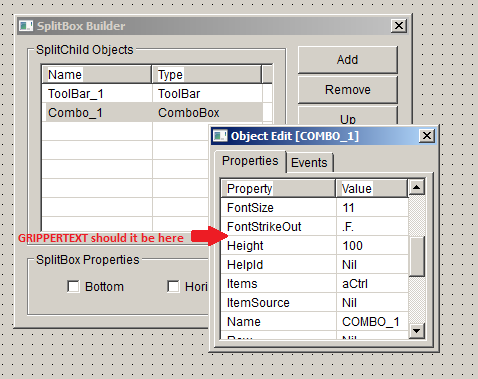

Split Builder is a good supporting tool in IDE. But is missing GRIPPERTEXT property for COMBOBOX.
The problem is when ever we change something in the designer form, all the manual job is lost.
GRIPPERTEXT is used to describe some text beside the ComboBox when is in the SPLITBOX.
Also I did not find any function/method to insert or change the GRIPPERTEXT.

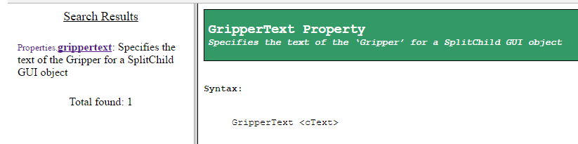

I found this on HMG_Doc:

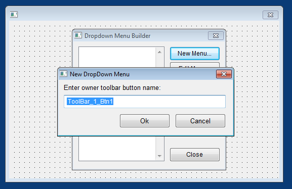

DropDown Menus when is in SplitBox is wrongly defined out of SPLITBOX in FMG

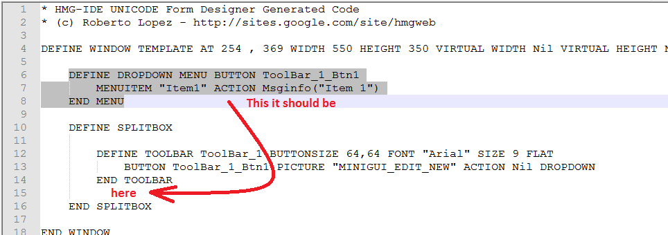

There is another bug when there is a DROPDOWN MENU in owned button, the form designer should save it in line after of END SPLITBOX in sequence. Because this sequence order mismatch causes an error in writing the form.
When this sequence order mismatch is corrected manually in the fmg file: IDE in form desginer (opening saved form) and compilling process work normally.

Please note in my re-edited previous message I am explaining about IDE is defining DropDown menus out of SplitBoxes defination:
For your tests you can take this sample demo:
TOOLBAR with SplitBox.rar
Source files
(807 Bytes) Downloaded 185 times
I think at the time is creating a DropDown menu, should it check that is IN the SplitBox.
IDE is creating out of order creating now the DropDown is defined previously the SplitBox and this causes an error saying that (button name owned) doesn't exist. Dropdown, also could it be the line after of END SPLITBOX and will also work ok. But DropDown not be before DEFINE SPLITBOX.
In your test, you can changer something with the IDE and save the form to see that you are defining the dropdown menu before the splitbox.
