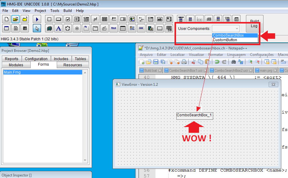

Hi all,
I do not know if some already knew this:
Wornderful. Is not it ? :shock: :D
To work in good order, you have to save this at \hmg.3.4.3\IDE\ComboSearchBox.uci:

You will need to open a FORM (fmg), then the IDE's ComboBox, will be enabled showing this option. (ComboSearchBox).
You can click on it and put on the form designer. Before you compile, add #include "hfcl.ch" in your prg.
This was announced by Roberto at (very long time ago): viewtopic.php?p=406#p406
