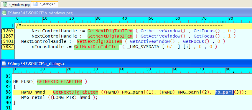

Post by KDJ »
If focus is in EditBox and you press Shift+Tab, focus will be set to the next control instead of the previous.
The third parameter in GetNextDlgTabItem is logical type, so
GetNextDlgTabItem ( GetActiveWindow() , GetFocus() , 1 )
works as
GetNextDlgTabItem ( GetActiveWindow() , GetFocus() , .F. )
Re: WM_NEXTDLGCTL and GetNextDlgTabItem
Thanks for report
